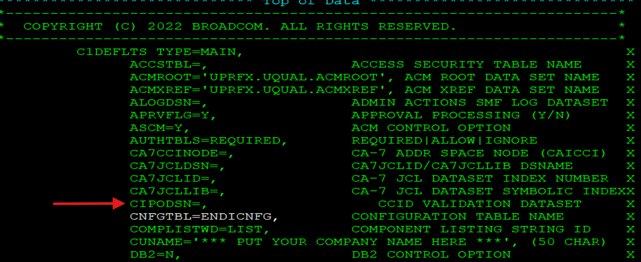

There are two things that have to be changed:
1.  In the C1DEFLTS table change the CIPODSN= (ccid validation dataset name)
FROM:
TO -
