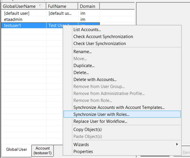

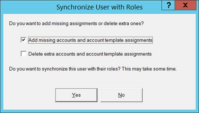

Once these two settings are changed to yes, the "Sync User with Roles" operation must be performed in order to associate existing accounts with their appropriate templates.
Then select the "Add missing accounts and account template assignments" option and click yes.
When the operation is launched, the system will try to create a new account based on the Provisioning Role and account template.
now, as the account already exists in the system but may be in a different container, the settings above will cause Identity Manager to ignore the container part in the account template and assign the account template the already existing account.
