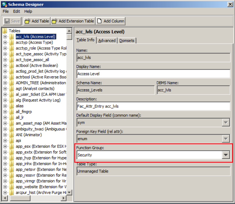

Check the Function Group on the Schema Designer if an appropriate value is set.
  1. Open the WSP.
  2. Click the Schema Designer button in the tool bar.
  3. Click a specific table icon that the customized form is linked in the left pane's tree.
  4. Check if the Function Group in the right pane is set an appropriate settings. You can compare this with another environment where the issue does not occur, or reach out to support for the correct value.
(This is for example. It is necessary to click an appropriate table icon you need to check in the tree)

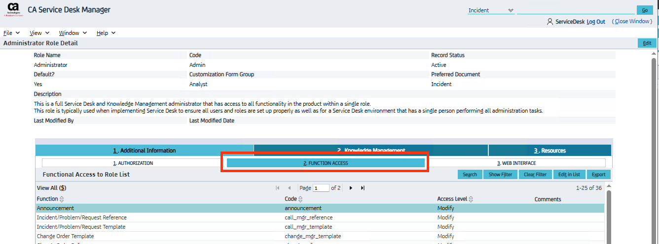

Check if all the Function Access are set to the correct access level settings in the Role detail screen.
