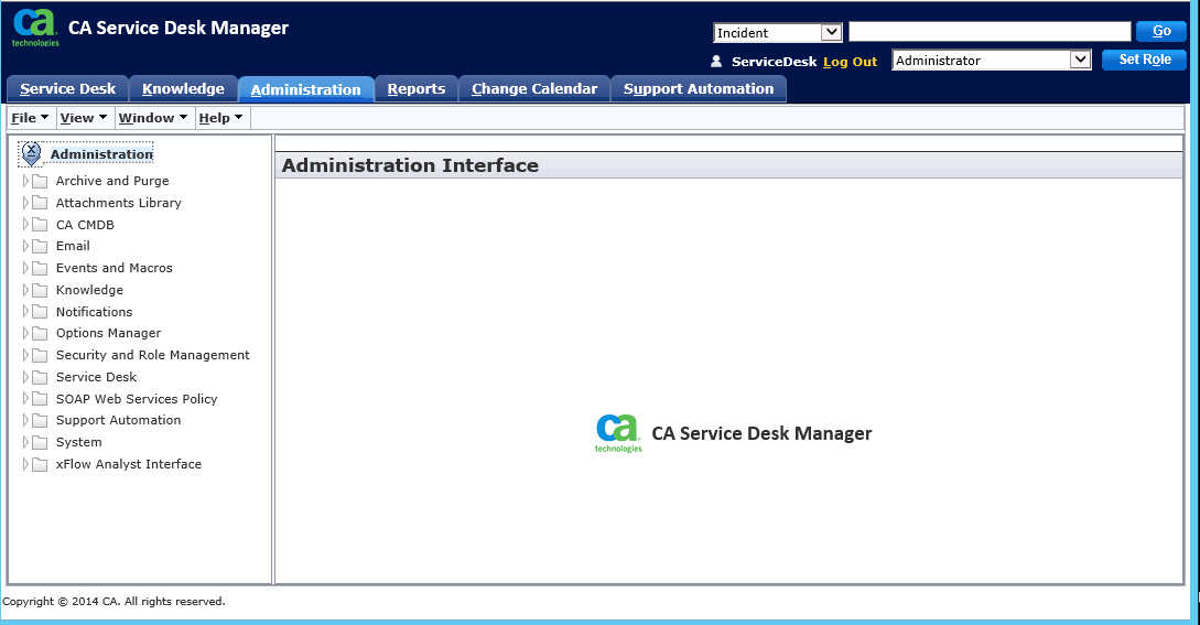

 1.  Log into CA Service Desk Manager with a user, such as "ServiceDesk", that has a role allowing access to the Administration tab and set the role accordingly.

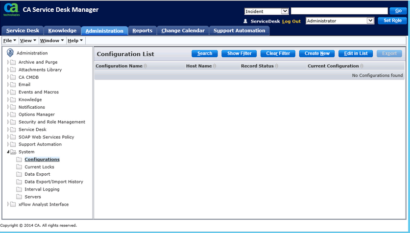

 2.  Click on the "Administration" tab and open the "System" folder and then click on "Configurations".
      The Configuration List is displayed.

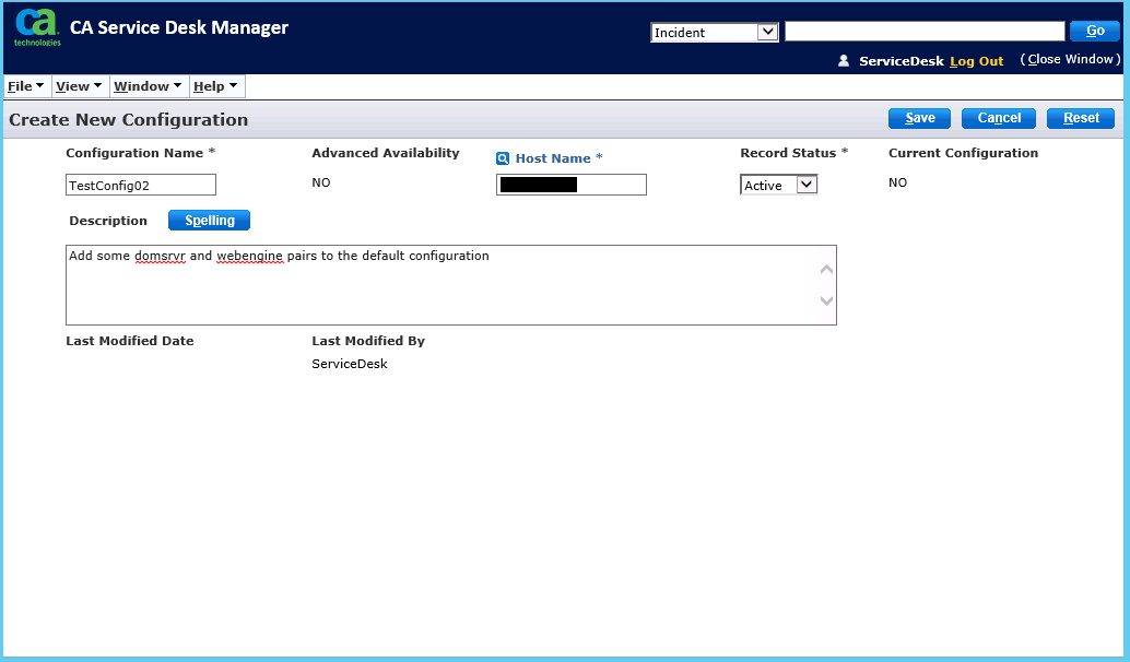

 3.  Click on "Create New" and enter the Configuration Name and the Host Name.
      "Create New Configuration" is displayed.
 4.  Click on "Save".

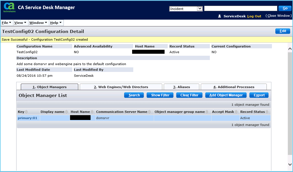

      "Configuration Detail" is displayed.

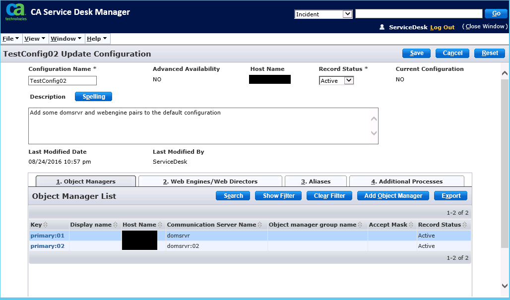

 5.  Click on "Edit".
      "Update Configuration" is displayed.

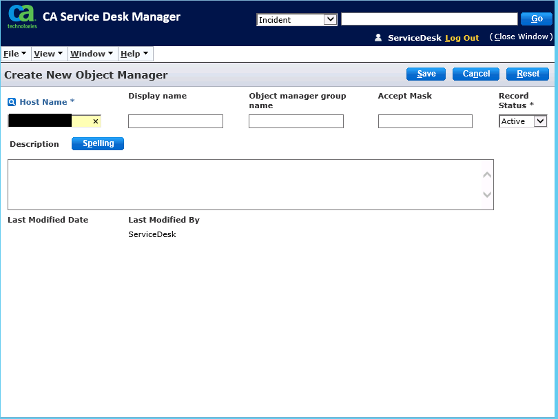

 6.  Click on "Add Object Manager".
      "Create New Object Manager" is displayed.
 7.   Click "Save". Then click "Search" in the "Object Managers" tab of the "Update Configuration" form that is displayed.
      After clicking "Search", the Object Manager List is refreshed and lists the newly created Object Manager, "domsrvr:02".

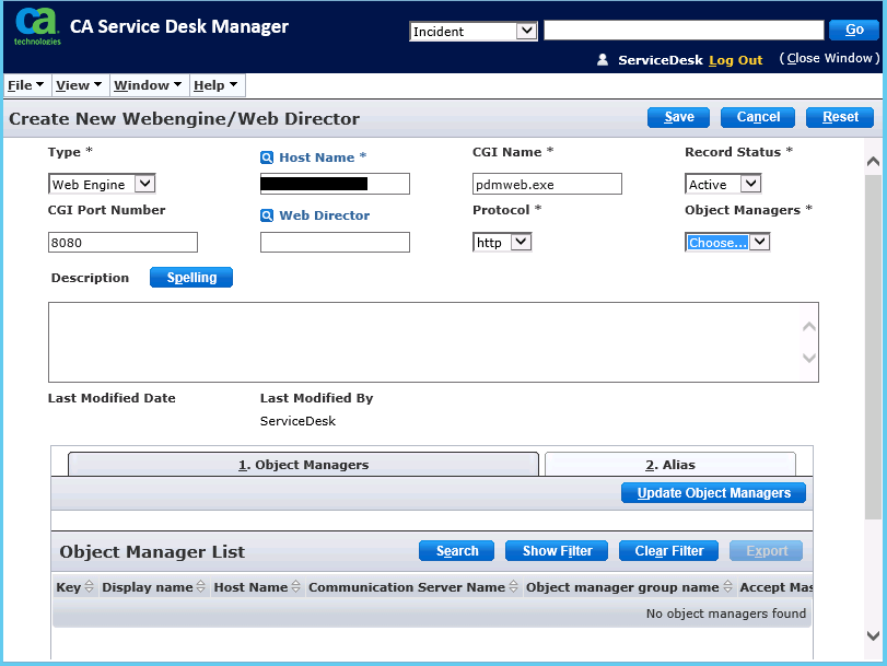

  8.  Click on the tab named "2. Web Engines/Web Directors".

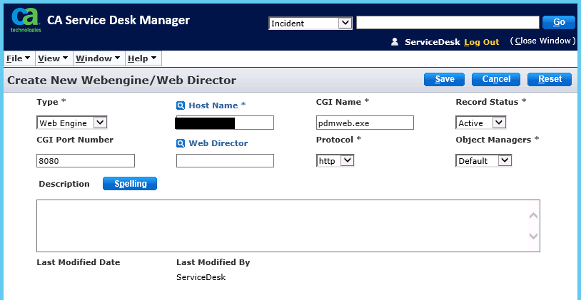

 9.  Click on "Add Web Engine/Web Director".
10.  Click on the dropdown under the "Object Managers *" form field title and select "Choose...".

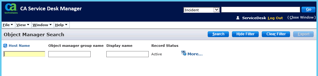

11.  Click "Update Object Managers" in the Object Managers tab.
      "Object Manager Search" is displayed.
12.  Click "Search".

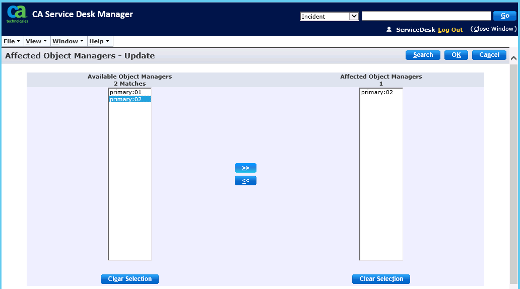

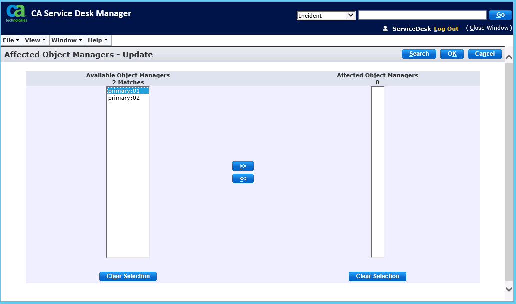

       "Affected Object Managers - Update" is displayed.
13.  Click on the object manager, in the "Available Object Managers" list on the left, that had been created in Step #6 ("primary:02") so that it is highlighted, and then click ">>".
       The selected object manager is added to the list of "Affected Object Managers" on the right.

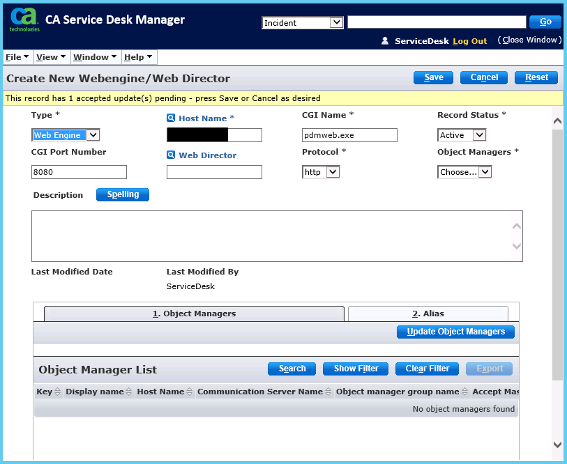

14.  Click "OK".

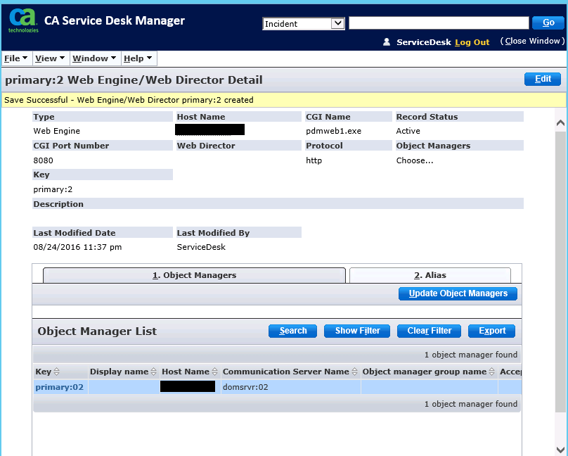

       "Create New Webengine/Web Director" is displayed with the new message "This record has 1 accepted update(s) pending - press Save or Cancel as desired".

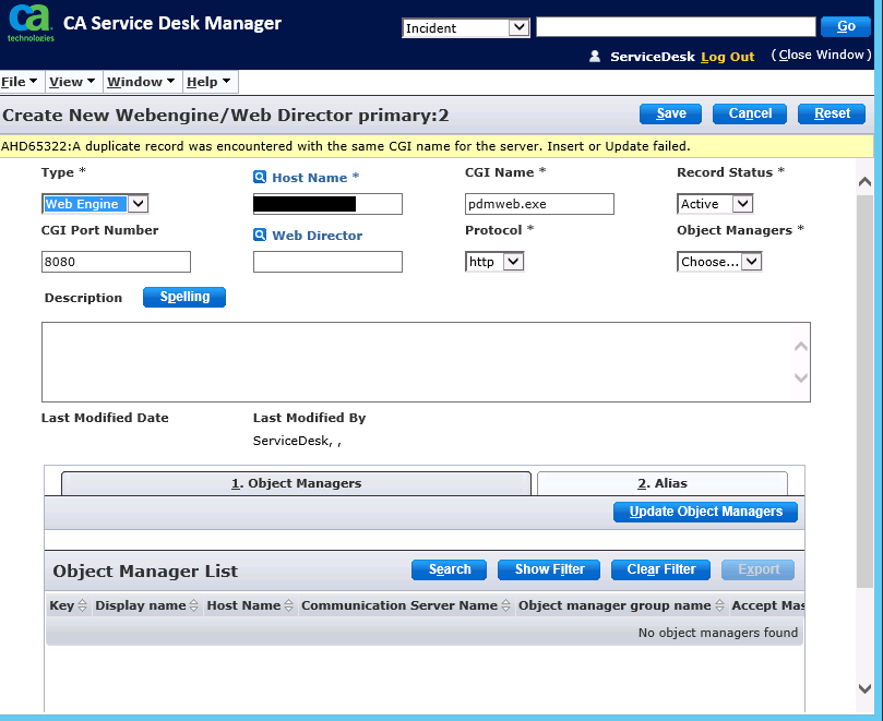

15.   Be sure that the "CGI Name" is unique. Click "Save".
If you receive "AHD65322:A duplicate record was encountered with the same CGI name for the server. Insert or Update failed.", then change the "CGI Name" to an unused name such as, in this case, "pdmweb1.exe". Then click "Save" again.

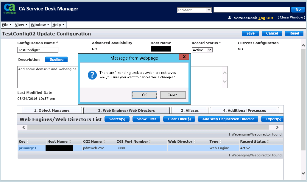

16.  Click "Close Window".
17.  Click "Save" in the "Update Configuration" window.
If you click "Close Window" before you click "Save", you will get a popup message asking you if you are sure that you want to cancel the change.
Click "Cancel" to cancel the closure of the window. Then click "Save" in the "Update Configuration" window.

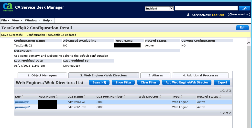

18.  Click "Close Window".
19.  In the "Configuration List", the new configuration should be listed.
      If not, be sure the "Record Status" of the Filter is set to "Active" and then click "Search">
      Noted that the value of "Current Configuration" for the new configuration item is "NO".

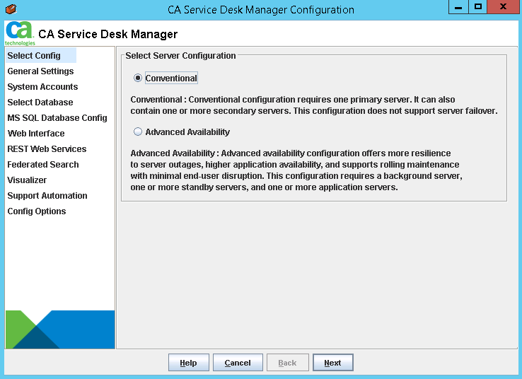

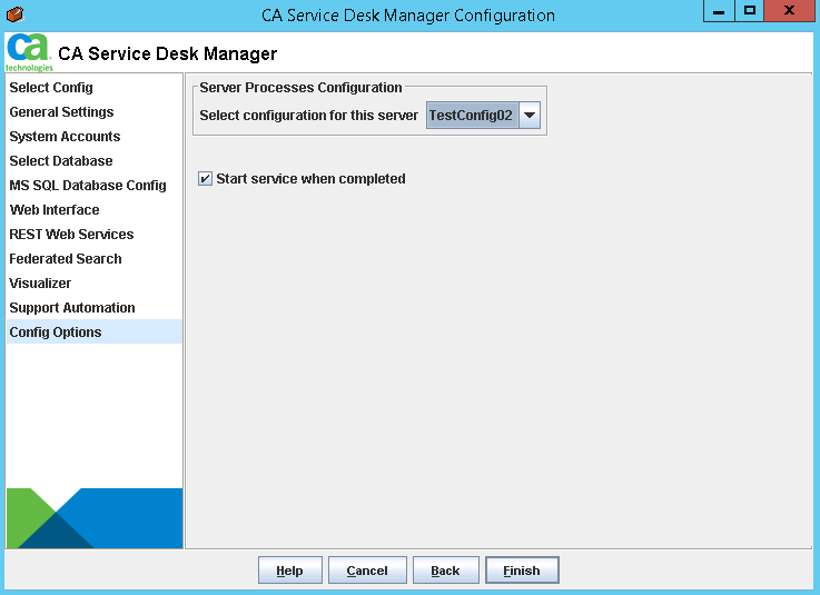

20.  In order to use the new configuration, you must run the Configuration tool (pdm_configure).
21.  During the "Config Options" step, select the new Configuration from the dropdown list. Then click "Finish".
