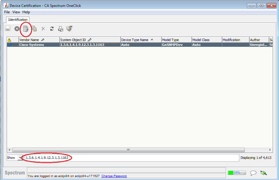

Cisco Nexus 3064 devices with a sysObjectID 1.3.6.1.4.1.9.12.3.1.3.1163 are modeling using the GnSNMPDev Model Type in Spectrum instead of the CiscoNXOS Model Type.

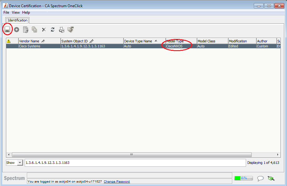

3. In the "Device Certification" view, filter for and select the oid 1.3.6.1.4.1.9.12.3.1.3.1163 entry

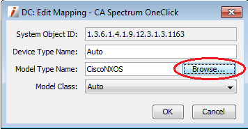

4. In the "DC: Edit Mapping" view, click on the "Browse" button and select the "CiscoNXOS" Model Type and then click on the "OK" button
5. In the "Device Certification" view, the entry for  1.3.6.1.4.1.9.12.3.1.3.1163 should now show "CiscoNXOS" in the "Model Type" column. Click on the "Save" button to save the change.
