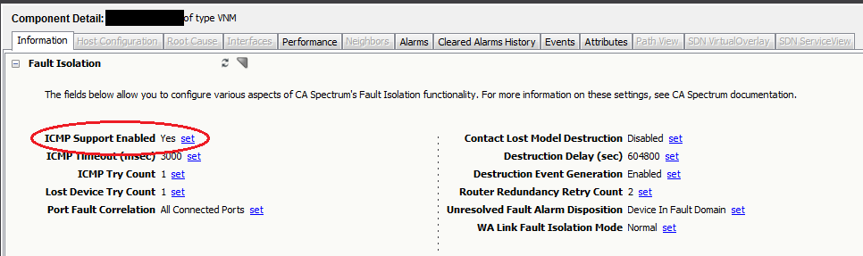

2. ICMP can be disabled globally by setting the "ICMP Support Enabled" parameter in the Fault Isolation subview of the VNM model to "No". This will disable ICMP for all models in the Spectrum database.
The documentation defines the "ICMP Support Enabled" parameter as follows:
Specifies whether an attempt should be made to contact a device using the ICMP protocol when trying to ascertain the fault status of the device. When the ICMP_SUPPORT attribute is enabled (set to TRUE), CA Spectrum looks at the setting of the ICMP_SUPPORT attribute at the device level. If ICMP support is also enabled on the device, CA Spectrum attempts to contact the device using the ICMP protocol. However, when ICMP_SUPPORT is disabled (set to FALSE), this setting takes precedence over the setting at the device level and prevents any attempt to contact the device using the ICMP protocol for fault isolation.
Default: Yes
