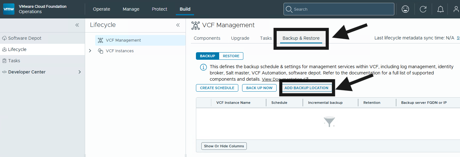

  • Configuring backup location from VCF Operations UI, fails with "Task with ID '####' from SDDC lifecycle with ID '####' has completed with failure(s). Check the errors in the next sub-task(s) for more details"

This issue occurs when the backup user account configured on the remote SFTP server lacks sufficient file system permissions for the designated backup path
Log into the SFTP server and verify that the backup service account has full read, write, download, upload and execute permissions on the target directory and its parent directories with correct ownership.
