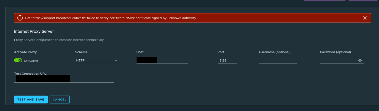

Configuring Licensing Hub to use a HTTP TLS inspecting MITM Web Proxy failed with "failed to verify certificate: x509 certificate signed by unknown authority" is the proxy is configured to reissue certificate using non-public CA certificate.
Licensing Hub 2.0
Licensing Hub 2.0 currently does not support connecting to Pulse over HTTP TLS inspecting MITM web proxy.
