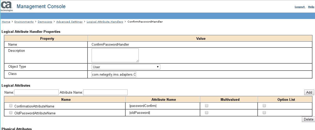

By default in an Identity Manager install, the "ConfirmPasswordHandler" is configured.  To see this, login to the Management Console and browse to Environments>Your Environment>Advanced Settings>Logical Attribute Handers> ConfirmPasswordHandler.  You will see the following:

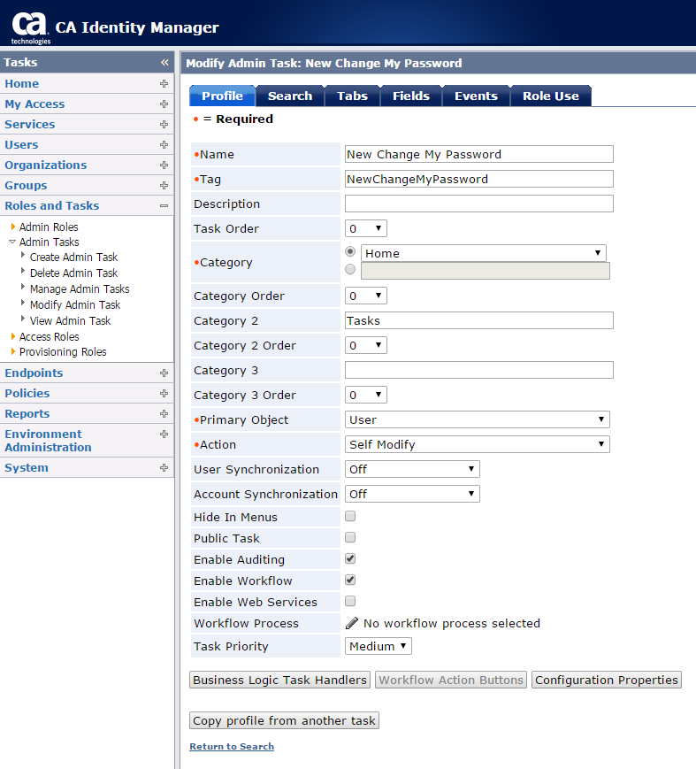

Notice the attribute name above is |oldPassword|.  This is the attribute we need to add to the screen for the Change My Password task.  To do this, login to the Identity Manager GUI as an administrator.  Browse to the task you want to modify (in our case "Change My Password") and it is suggested that you make a copy of this task to modify.  To do this, select to create a new task and you will be prompted to copy an existing task.

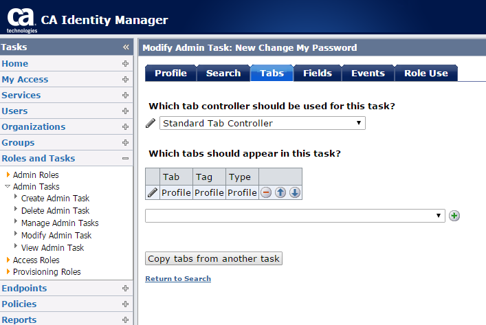

Click on the Tabs tab:

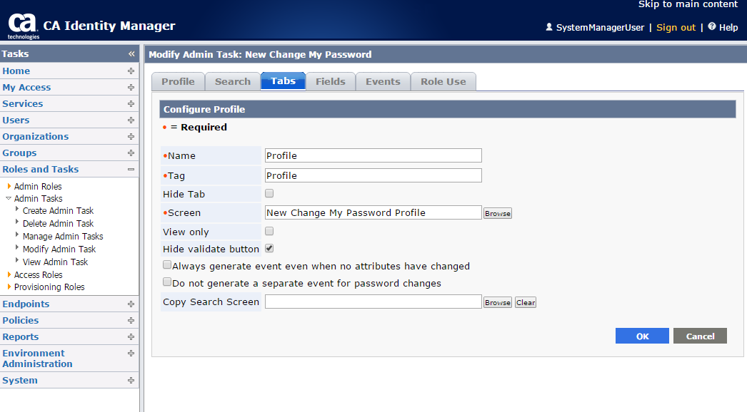

Click the pencil icon next to the Profile:

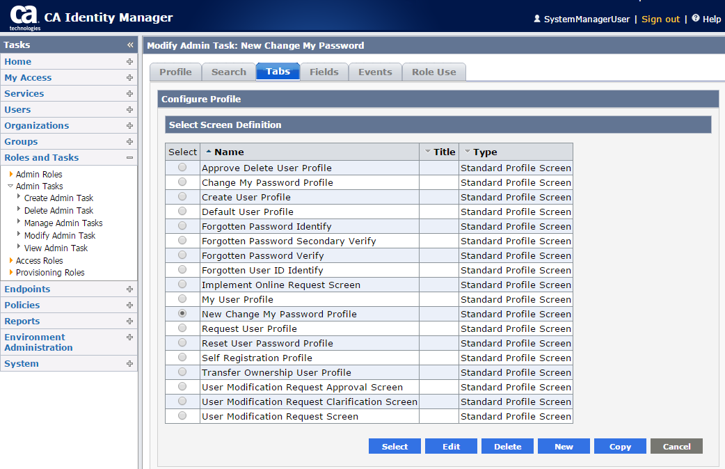

Click the Browse button next to the Screen field:
Here you can select to "Copy" the existing screen if you are creating a copy of the existing task and you don't want to modify the screen for the existing task.  Otherwise click the "Edit" button.

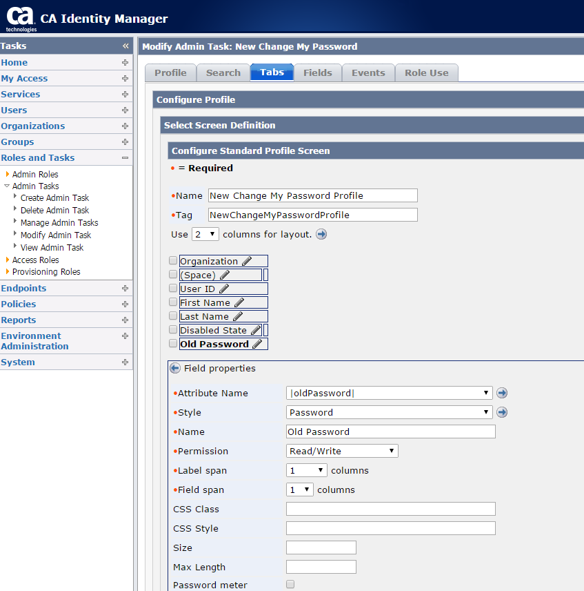

Click the button to add an attribute to this screen and select |oldPassword| from the drop down:
Change the "Style" to Password.  You can also change the "Name" field (as done above) to be a more user friendly name on the screen presented to the user.
Repeat these steps to add the "DisabledState" Attribute to this screen (if it isn't already there).  Leave that field as hidden.

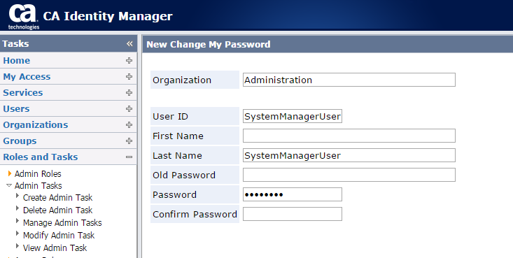

So now login to Identity Manager as a user who has this new task included and launch the new task.  You should see the following screen:
