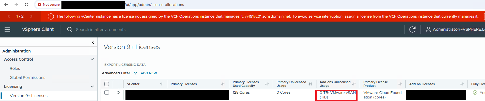

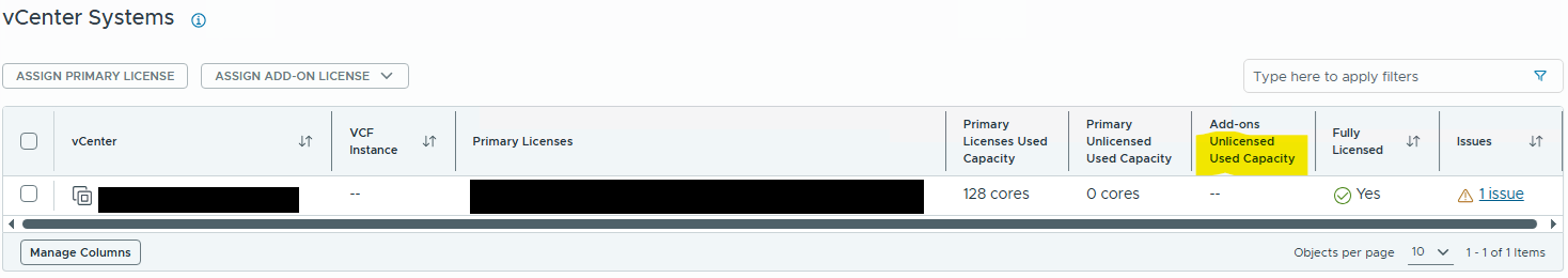

When you change licenses from VVF with a vSAN Add-on license to VCF the following shows in the vCenter under licensing:
This is due to VMDIR for vCenter holding onto the older subscription licensing for VVF and not cleaning up.
This is a cosmetic issue and should not cause any issues. If this needs to be cleaned up the followings steps can be used:

  6. After the above deletes have been completed, refresh the browser and check that the "Add-ons unlicensed usage" is no longer showing
