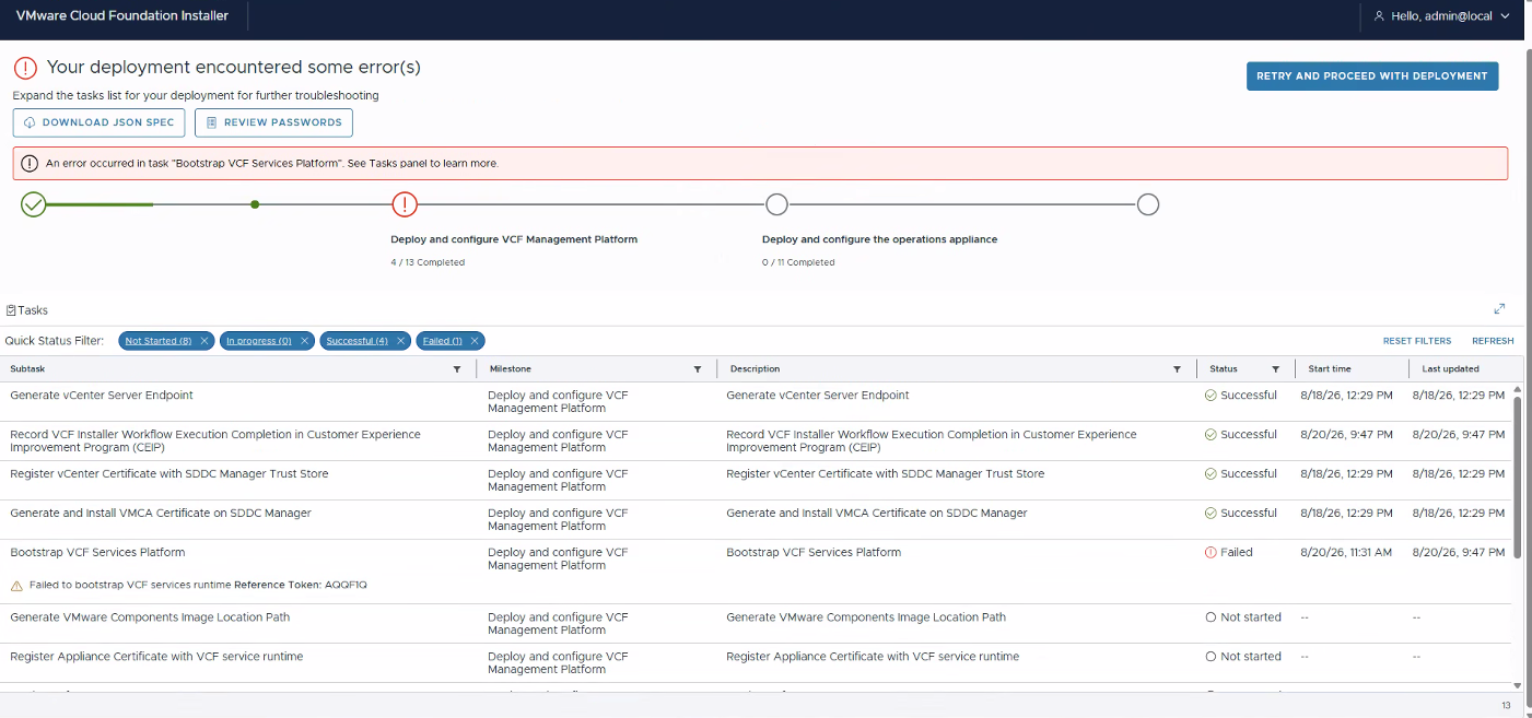

  • Generic error shown in the VCF Installer on the Bootstrap VCF Services Platform stage with error : "Failed to bootstrap VCF services runtime"

The bootstrap is failing due to a mismatch in the provided vCenter certificate's thumbprint and the thumbprint that is obtained from the live vCenter server.
Deploy using the 9.1.1 bundle instead of 9.1.0 as the 9.1.1 version has resolved issues with this installer error.
