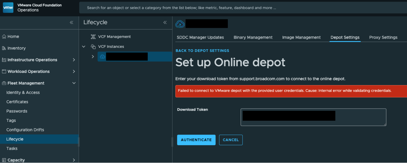

  • Configuring the Online depot with download token from VCF Ops UI -> Fleet Management -> Lifecycle -> VCF Instances -> <VCF Instance Name> -> Depot Settings -> <Enter Download Token> -> Authenticate fails with below error message.
    Failed to connect to VMware depot with the provided user credentials. Cause: Internal error while validating credentials
