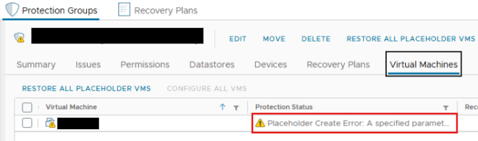

Symptoms:
  • Placeholder VM creation task fails with error: "Placeholder Create Error: A specified parameter was not correct: spec.managedBy.extensionKey"
  • The VM protection task fails with error: "Operation Failed A specified parameter was not correct: spec.managedBy.extensionKey"
