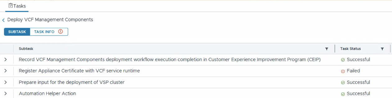

  • In VMware Cloud Foundation 9.1, an FQDN-related failure during the VCF Management Components deployment left an orphaned Bootstrap Virtual Machine in the vCenter inventory, which was subsequently deleted manually.
  • The task "Deploy VCF Management Components" is then retried which fails at "Failed to register the appliance certificate with VCF services runtime".
