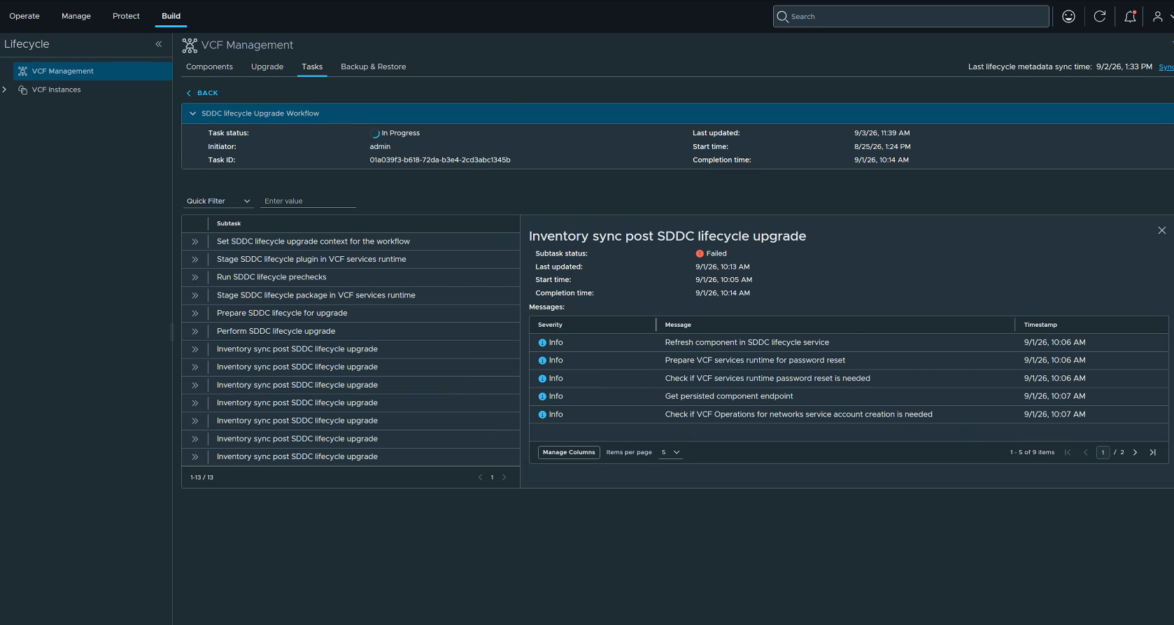

When performing component registration, refresh, upgrade, or scale-out operations in VCF Operations, the process fails with an HTTP 400 error.
The following errors may be observed in the VCF Operations UI.
  • An unexpected error occurred in step register_single_component_in_ops_ref__1. Reference Code: 33072210.
    Detail: Unexpected VCF Operations Suite client error has occurred. Cause: Message:
  • HTTP response body: {"type":"Error","message":"Unknown error occurred.","moreInformation":[{"name":"OPERATION","value":"LOCKER_REFERENCE_CREATE"}],"httpStatusCode":400,"apiErrorCode":400}
  • Refresh component in Fleet lifecycle
    Fleet lifecycle '#######' refresh has failed.
  • Other reference codes associated with this issue could include but not limited to: 63377924, 5507099A, and ED50381C.

  • Installing the log management failed with an error "An unexpected error occurred in step register_single_component_in_ops_ref_1. Reference Code: 415685E8" in VCF Operations UI task page.
    An unexpected error occurred in step register_single_component_in_ops_ref_1. Reference Code: 415685E8.
