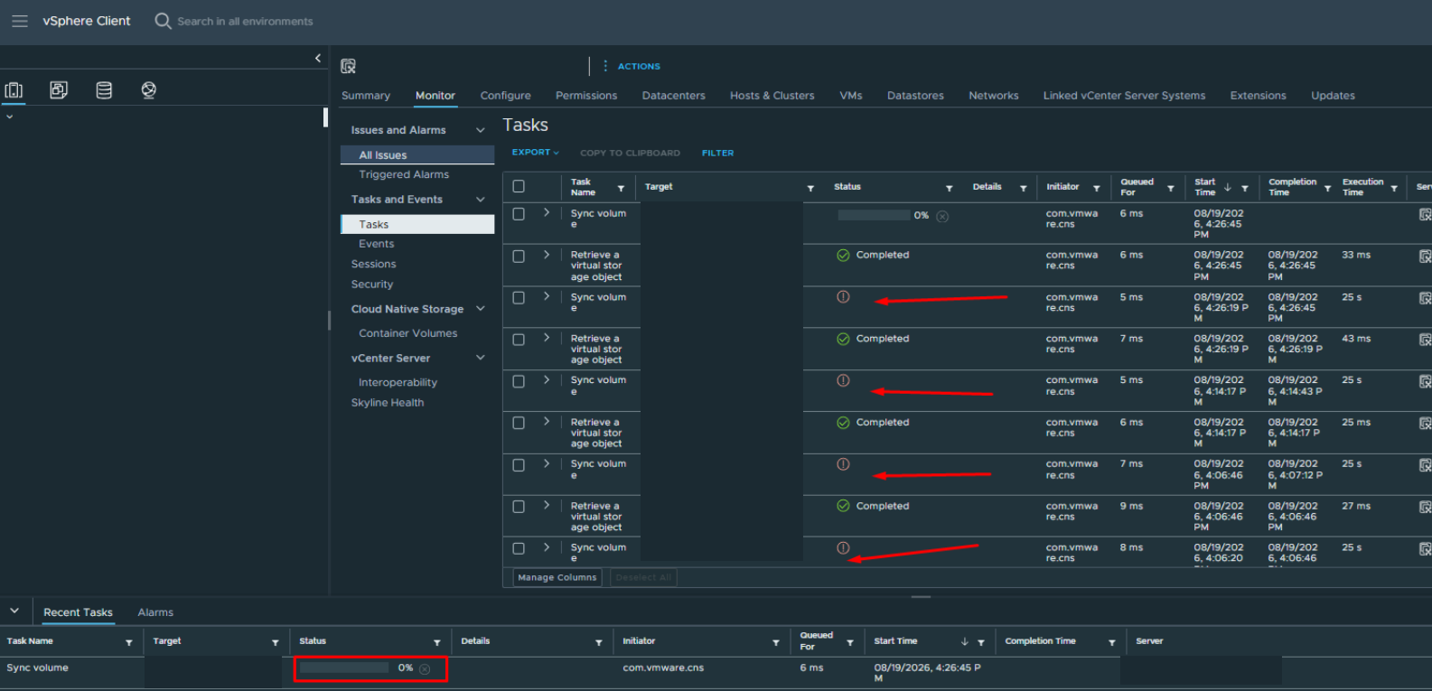

  • Confirmed that the issue is not a match of similar KB CNS tasks in vCenter Server frequently fail with the error, A specified parameter is not correct.
  • The datastore shared across vCenter Server instances.
  • In the journalctl log, the following log repeatedly occurs.
    [vim.event.TaskEvent] [info] [com.vmware.cns] [] [***] [Task: Retrieve a virtual storage object]
    [vim.event.TaskEvent] [info] [com.vmware.cns] [] [***] [Task: Sync volume]
  • In the vpxd log, failed lock vmdk file log repeatedly occurs.
    yyyy-mm-ddThh:mm:ss.nnn error vpxd ERROR VStorageObjectManager – vim.vslm.vcenter.VStorageObjectManager.retrieveVStorageObjectMetadata: :vmodl.fault.SystemError
    --> Result:
    --> (vmodl.fault.SystemError) {
    --> faultCause = (vmodl.MethodFault) null,
    --> faultMessage = <unset>,
    -> reason = "Failed to lock the file: api = D
vSphere Container Storage Plug-in does not support datastores shared across vCenter instances.
See vSphere Functionality Supported by vSphere Container Storage Plug-in
Detach LUNs so that there are no shared datastores across multiple vCenters and carefully review the Pre-unmount checklist in the following KB
