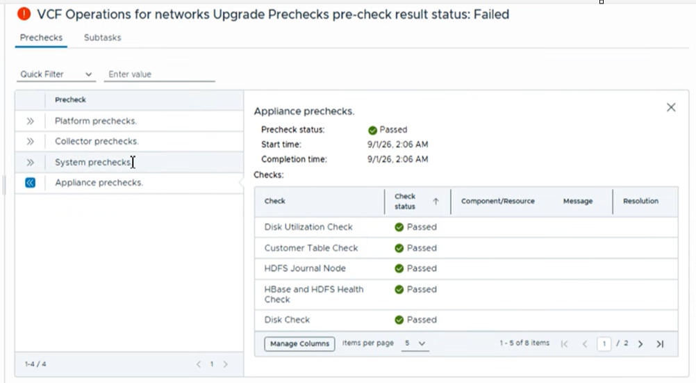

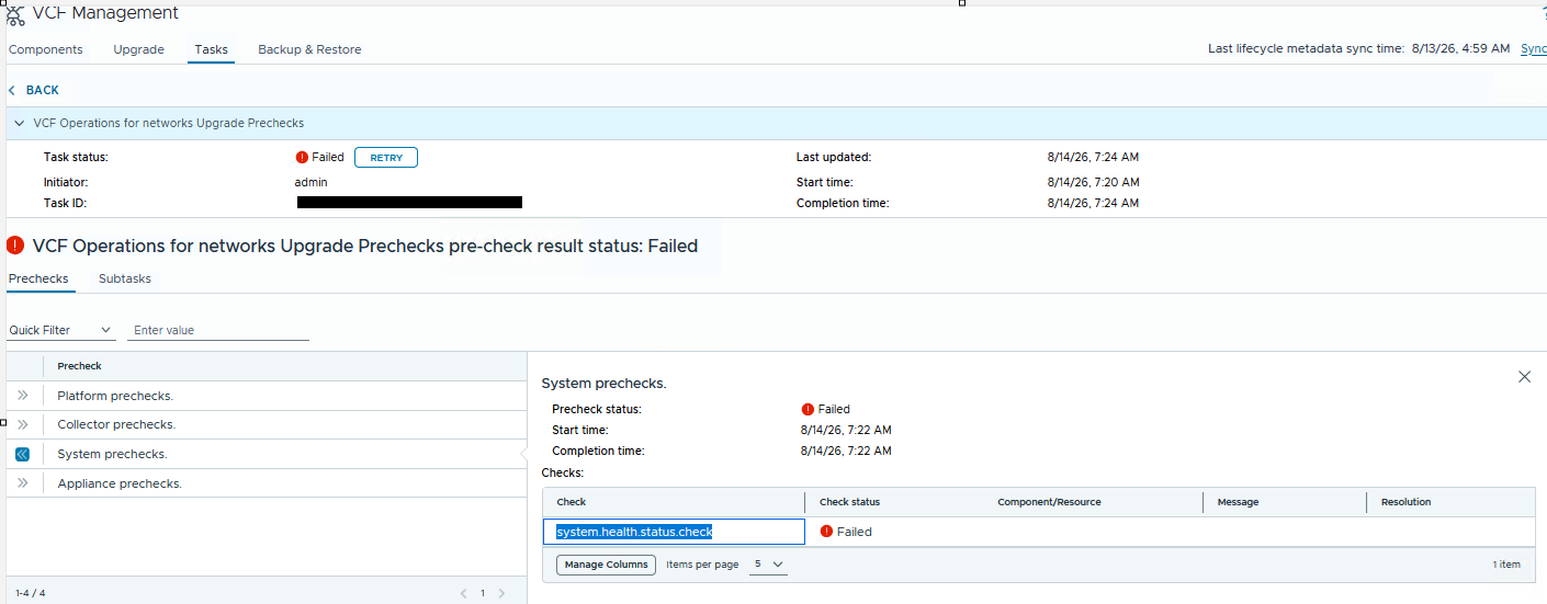

  • The upgrade precheck failed with the following error in the VCF Operations under Fleet Manage Management Console:
  • All other prechecks may complete, except for the system prechecks.

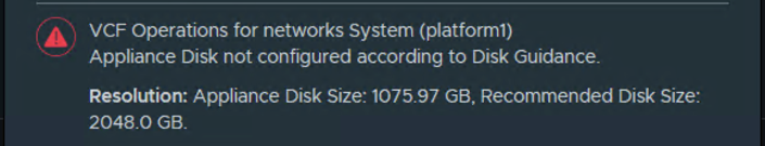

  • The VCF Operations for Networks platform appliance is deployed with an X-Large brick size; consequently, you may encounter the following warning in the VCF Operations for Networks GUI under Settings > Infrastructure and Support.

The VCF Operations for Networks Platform appliance failed the upgrade precheck because its allocated storage disk capacity did not meet the mandatory system prerequisite requirements for the configured Extra Large (XL) brick size.
To resolve this, attach an additional 1 TB storage disk to the VCF Operations for Networks Platform VM to meet the prerequisite disk space requirements for the Extra Large (XL) brick size.
