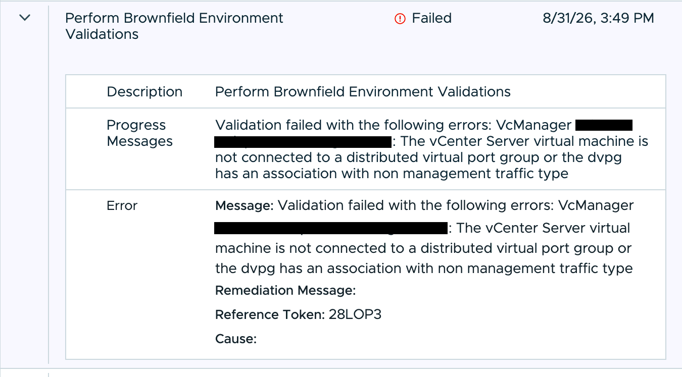

Validation fails during domain sync or import domain workflow with the error:
"The vCenter Server virtual machine is not connected to a distributed virtual port group"
