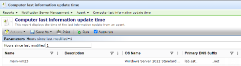

Pre-installed report: "Computer last information update time" (GUID b30198eb-4fa5-47e1-a334-aac2ed79161d)

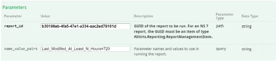

b30198eb-4fa5-47e1-a334-aac2ed79161d name_value_pairs query parameter. Last_Modified_At_Least_N_Hourscurl -X POST --header 'Content-Type: application/json' --header 'Accept: application/json' 'https://ns_machine/Altiris/

]Name gives the computer name. Date Modified gives the last reporting date. Hours Since Last Modified confirms the row falls inside the requested window.If the pre-installed report doesn't return the exact fields needed, build a new report in the console (for example, using "Save As" from an existing report, or a new SQL/dynamic report), then run it through the same /ReportManagement/reports/{ endpoint using its own GUID.
