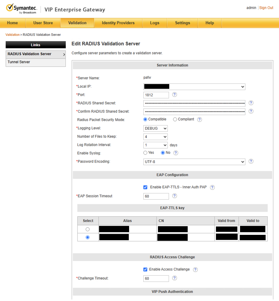

EAP-TTLS authentication fails when connecting to VPN via Palo Alto Networks GlobalProtect and Enterprise Gateway.
The Validation Server has been configured with the required EAP-TTLS key in accordance with the official product documentation.

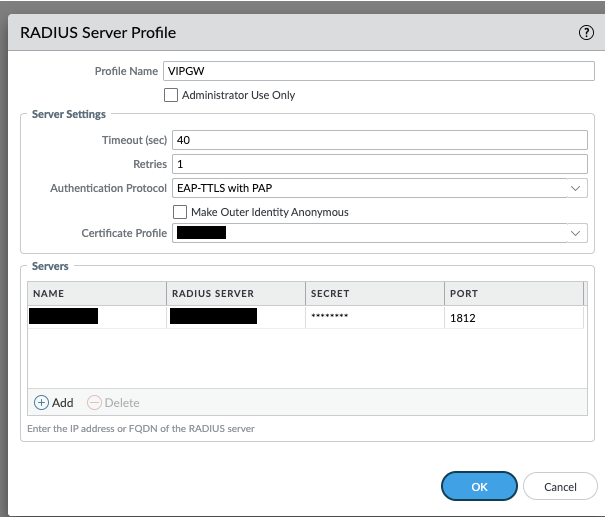

RADIUS Server Profile: Configured on the Palo Alto Networks firewall as follows:

VIP Enterprise Gateway 9.11.3
As per Palo Alto admin guide, EAP-TTLS is supported when password or token or pin are provided together, which is non-interactive access-challenge flow. To support challenge-response flow, one of PAP, PEAP or GTC is to be used. Palo Alto GlobalProtect VPN is not supporting interactive access-challenge flows in the EAP-TTLS-PAP mode.
We recommend implementing the following authentication flow when integrating with Palo Alto Networks GlobalProtect:
  • ULO Mode: Users can authenticate using one of the following methods:
    • Password + OTP: Enter the LDAP Password + Security Code (OTP) directly.
    • Push Authentication: Enter the LDAP Password alone, which automatically triggers a VIP Push notification (provided the user has an active push credential registered).
