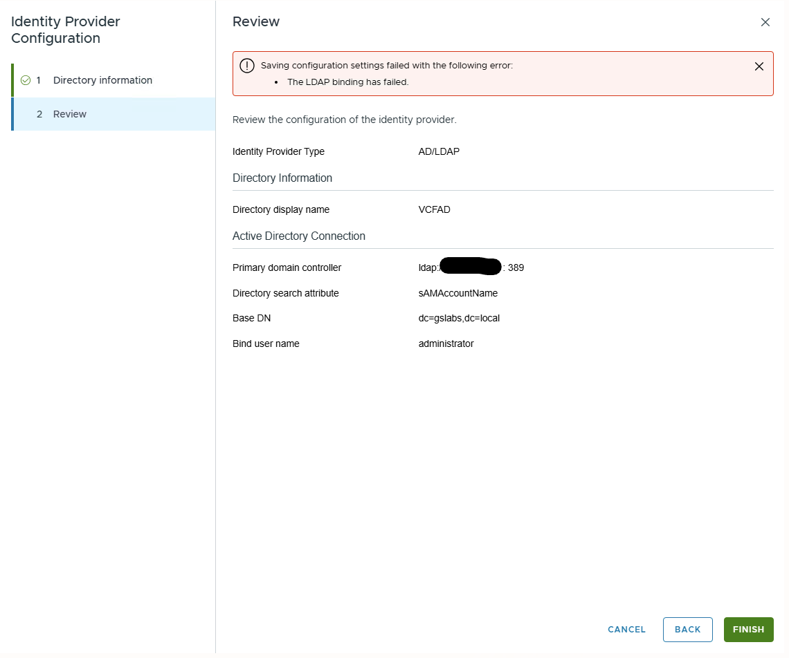

When configuring an Identity Provider (IDP) using the embedded VCF Identity Broker in VMware Cloud Foundation 9.0 / 9.x, the setup fails.
UI Error: The user interface displays the following message:
Saving configuration settings failed with the following error: The LDAP binding has failed.

This issue occurs because the Bind User Name (bindDn) was entered using a non-standard username format (such as administrator or DOMAIN\administrator).
The VCF Identity Broker requires the Bind User Name to be specified in full LDAP Distinguished Name (DN) format (e.g., CN=...,OU=...,DC=...) to properly evaluate and authenticate the bind request against Active Directory.
To resolve this issue, update the Identity Provider configuration settings to use the full LDAP Distinguished Name (DN) format for the Bind User.
Standard LDAP DN : CN=Administrator,CN=Users,DC=domain,DC=local
Save the configuration and retry the Identity Provider bind operation.
