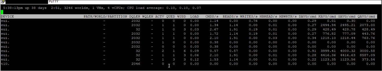

After migrating clustered VMs with shared VMDKs using Dell SRDF to NVME over TCP VMFS datastores, disk latency is severely high upon powering on the VMs, making them unusable.
ESXTOP shows extremely high KAVG, GAVG, QAVG
Both the VM and the host go into a hung state, requiring a reboot of the host to get out of the hung state
