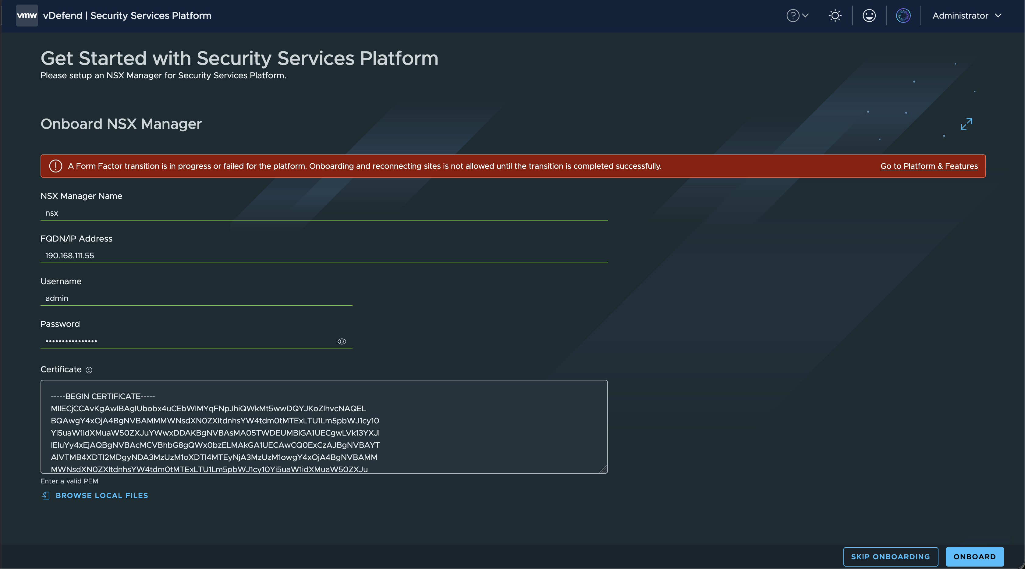

On a newly deployed Security Services Platform (SSP), onboarding a site fails immediately with the following error:
A Form Factor transition is in progress or failed for the platform. Onboarding and reconnecting sites is not allowed until the transition is completed successfully.

The SSP records its deployed form factor in the platform configuration only after the deployment has fully completed. The site-service that handles site onboarding reads this configuration once, when it starts up, which happens before the value has been recorded. It therefore holds an empty value in memory for as long as it keeps running, and interprets that empty value as an in-progress form factor change, blocking onboarding.
The platform itself is correctly configured and is not undergoing any form factor change. Only the onboarding service's in-memory copy of the configuration is out of date.
To reolve this issue, site service needs to be restarted.
