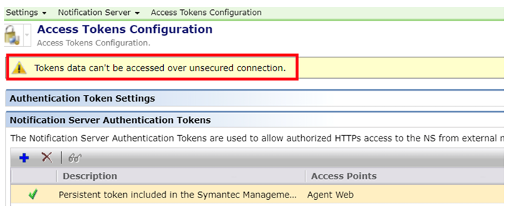

  • Retrieving tokens over HTTP — this is blocked outright; token retrieval requires HTTPS. You may see the message "Tokens data can’t be accessed over unsecured connection" in the Access Tokens Configuration page.

Clarification — HTTP is supported for client-server tokens:
The Access Tokens Configuration page's HTTPS warning applies only to creating or retrieving Notification Server tokens in the SMP Console (used for ASDK and Internet Gateway access — see Additional Information). It does not apply to the token-based authentication this article sets up. Agent-to-server authentication works over HTTP or HTTPS, and those tokens are generated and renewed automatically; there's no token to create manually for this connection.

Note:
The Access Tokens Configuration page displays the warning "Tokens data can’t be accessed over unsecured connection" if you create or retrieve a Notification Server token (ASDK or Internet Gateway use) over HTTP — that specific action requires HTTPS. This does not apply to the client-to-server setup in this article: agent tokens work over HTTP or HTTPS and require no manual creation.
