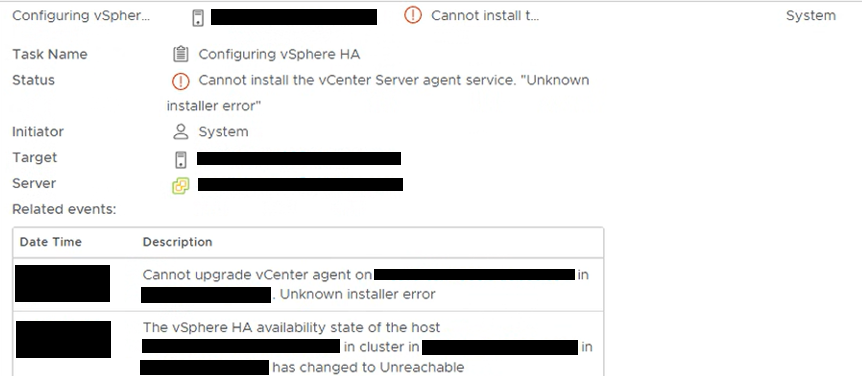

  • vSphere HA configuration on an ESXi host fails, and the host status displays HA Agent Unreachable or Uninitialized.
  • The vCenter Server UI report errors indicating the vCenter Server agent service cannot be installed.
