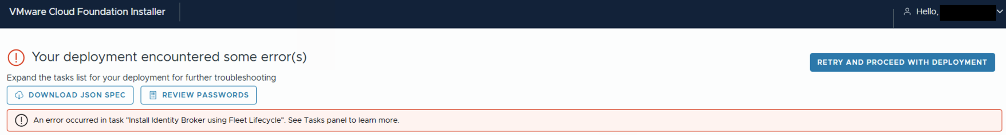

  1. VCF Deployment Fails with below error:
  2. The sub-tasks displays the below event:
    The Fleet litecycle "VSP component installation' task with ID <Task_ID> failed.
    Internal errors: Component FQDN <FQDN> resolved to IPv4 address <##.##.##.##>, which is not within the VSP network <IP Address/CIDR>.
    Reference Token: LR76VD
