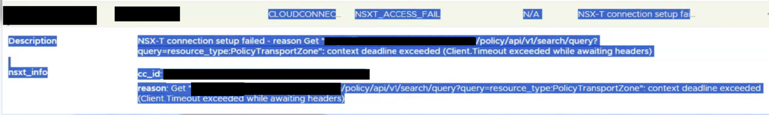

  • We see events on Avi UI under operations > events > All events, with respect to NSX or vCenter accessibility issues
  • Logs mentioning “Stale Route Deleted from Tier1” is seen in /var/lib/avi/log/cc_agent_go_<cloudname>.log on Avi Controller leader node.

  • Intermittent API timeouts from NSX-T and vCenter authentication failures caused Avi  cloud discovery to fail, which cleared internal caches.
  • During a subsequent discovery cycle, the controller found no valid VRF contexts and mistakenly assumed existing static routes were stale, briefly deleting them from the Tier-1 gateway.
  • This race condition caused the temporary VIP unreachability until API connectivity restored and the routes were recreated
