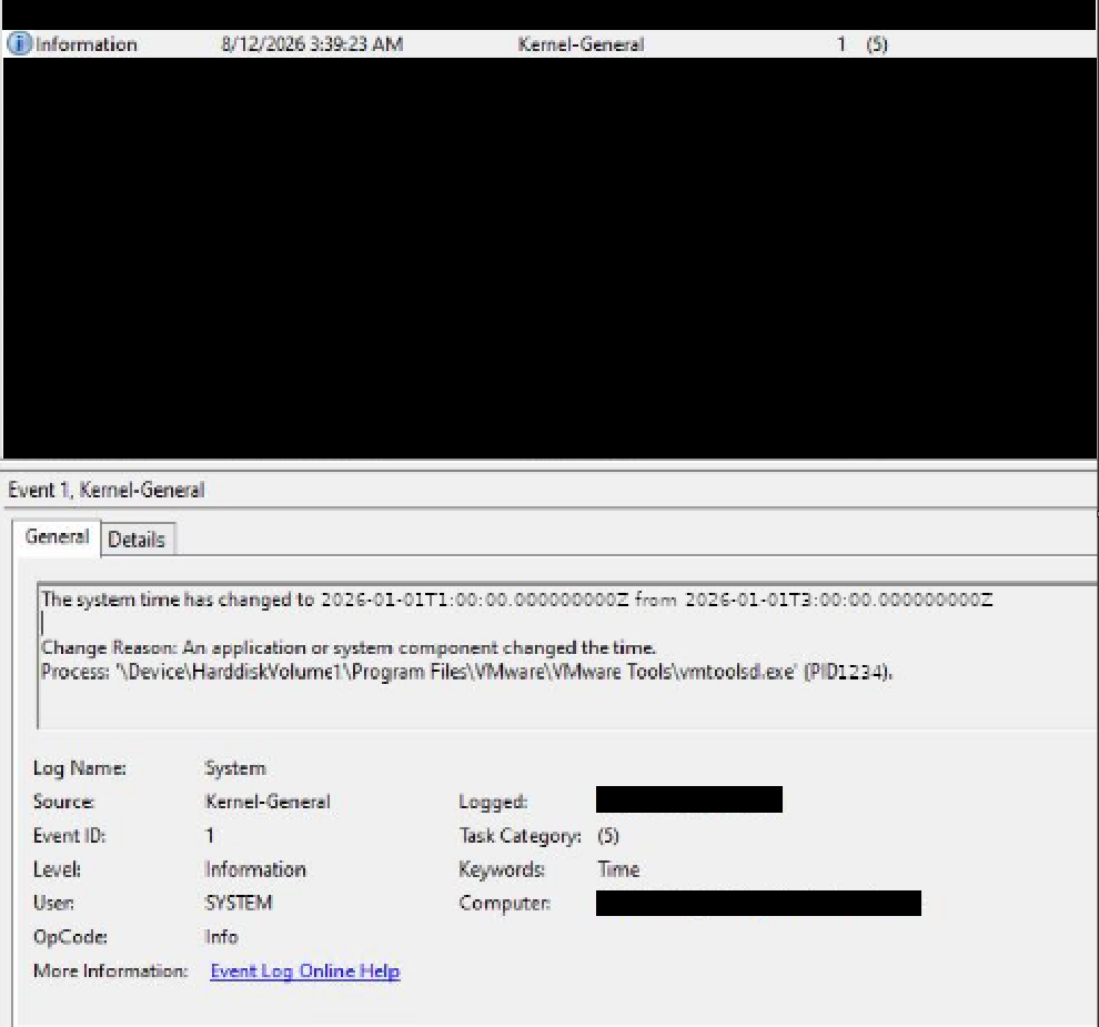

  • When viewing the Windows Event Viewer for the VM within the guest OS, there are Kernel-General information events similar to the following:
    • The system time has changed to 2026-01-01T1:00:00.000000000Z from 2026-01-01T3:00:00.000000000Z.
    • Change Reason: An application or system component changed the time.
    • Process: '\Device\HarddiskVolume1\Program Files\VMware\VMware Tools\vmtoolsd.exe' (PID 1234).

This issue can occur when the vmwTimeProvider component is installed during the VMware Tools installation process, but the virtual machine lacks the required "Precision Clock" virtual hardware device. Because the plugin attempts to sync time with a non-existent hardware device, it conflicts with the native Windows Time service (W32Time), leading to time synchronization instability.
