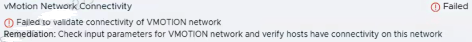

This article details troubleshooting steps for VCF 9.0 and 9.1 deployment failures during the "Validate vMotion Network Connectivity" pre-check.
Symptoms
  • Installer pre-check fails with "vMotion Network Connectivity" error.
  • ESXi hosts become "not responding" during configuration push.
  • Deployment log shows packet loss during vMotion ping test.
