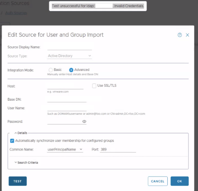

This article outlines the steps to resolve Active Directory (AD) integration issues in VCF Operations 9.1. When attempting to configure an AD authentication source via the Administration console, the system returns the error: "Test unsuccessful for ldap: <domain> Invalid Credentials." This symptom prevents the successful addition of the identity source and subsequent user authentication within the platform.
VCF Operations 9.x
The "Invalid Credentials" error during an LDAP connection test is typically caused by incorrect parameters in the Authentication Source configuration:
  1. Incorrect Base DN: The provided Base Distinguished Name (DN) string does not correctly point to the directory structure, preventing the system from querying the target partition.
  2. Service Account Username Format: Providing a shortname (e.g., "username") rather than a fully qualified format (e.g., "DOMAIN\username", "[email protected]", or "CN=username,DC=domain,DC=com") prevents the identity provider from successfully binding to the LDAP server, resulting in an authentication failure.

  2. Update Authentication Source Configuration:
    • Log in to the VCF Operations console.
    • Navigate to Operate > Administration > Control Panel > Authentication Sources.
    • Locate the AD Authentication Source configuration and click Edit.
    • Base DN: Update this field with the correct path retrieved from the dsquery command.
    • User Name: Update this field from the current shortname to a fully qualified format (e.g., DOMAIN\username, [email protected], or the full DN format CN=username,DC=domain,DC=com).
  3. Validate Configuration:
    • Click Test to confirm authentication is successful.
    • Once the test succeeds, click Save to commit the configuration changes.
