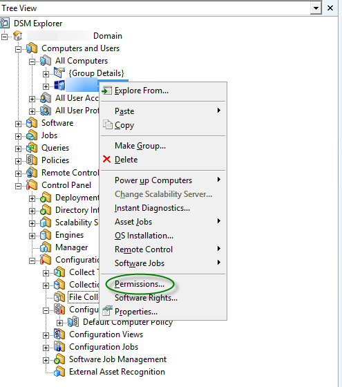

  1. Under "All computers", Right-click on one of machines you could not delete ->  Select "Permissions"

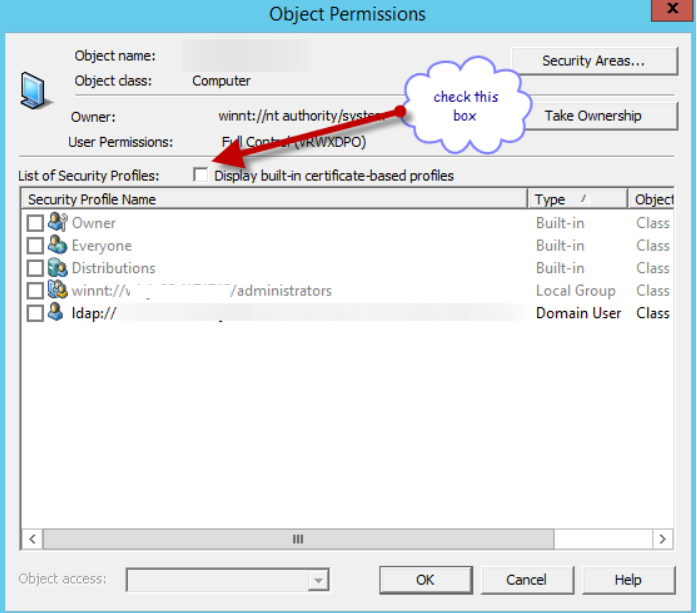

  1. Check the box "display built-in certificate-based profiles"

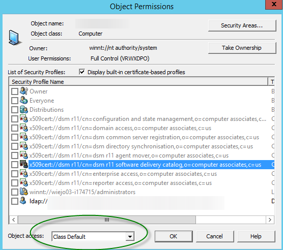

3.Select the line < x509cert://dsm r11/cn=dsm r11 software delivery catalog... > and in the listbox select < Full Control >
  1. click OK and you should not get the Error again.
