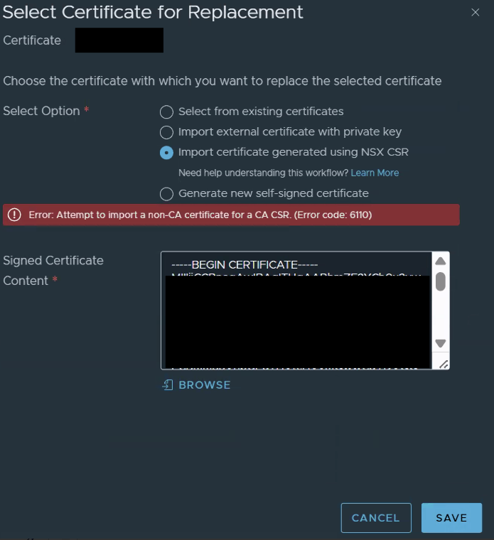

  • When attempting to replace the custom CA certificate in NSX, the operation fails with error
  • Error: Attempt to import a non-CA certificate for a CA CSR. (Error code: 6110)
VMware NSX

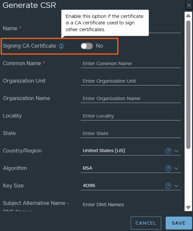

This issue occurs if the Signing CA Certificate option is enabled (set to "Yes") when generating the Certificate Signing Request (CSR). For standard API certificate replacement, this option must be set to "No."
Resolution: To resolve this issue, perform the following steps to regenerate the CSR and replace the certificate:
  1. Regenerate the CSR:
    • Navigate to the CSR generation interface in your NSX environment.
    • Ensure that the Signing CA Certificate option is explicitly set to No.
    • Complete the CSR generation process with the correct parameters.
