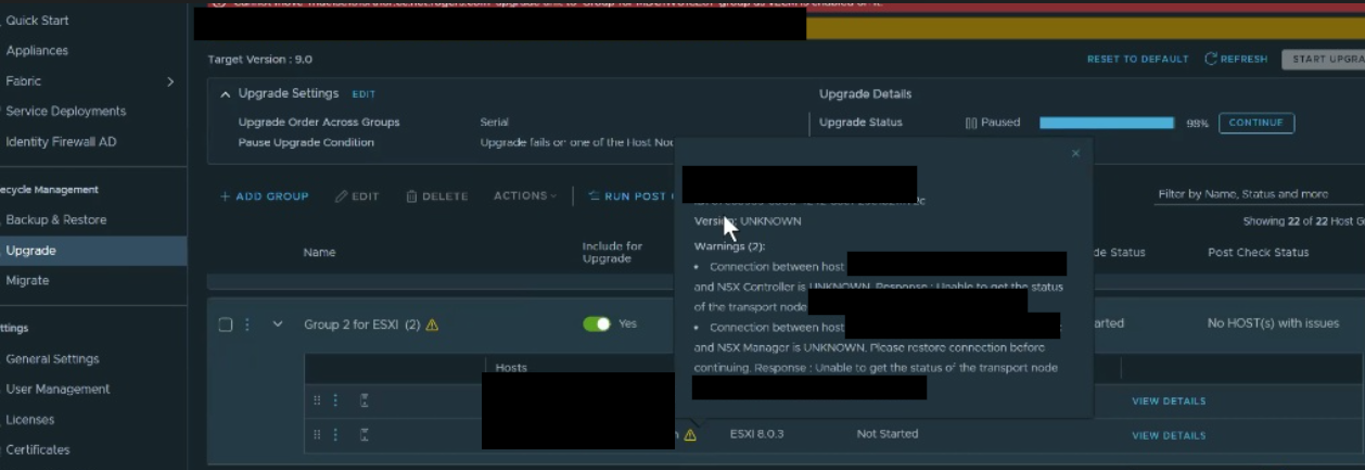

  • During an upgrade to NSX 9.0.2, the process gets stuck and pauses at 98% in the "finalize upgrade" phase. You'll see the following warning pop up in the Upgrade Coordinator UI:
Connection between host and NSX Controller / NSX Manager is UNKNOWN
  • When reviewing the NSX inventory, multiple duplicate ESXi host entries with different IP addresses appear as Disconnected or UNKNOWN under Standalone Hosts.
