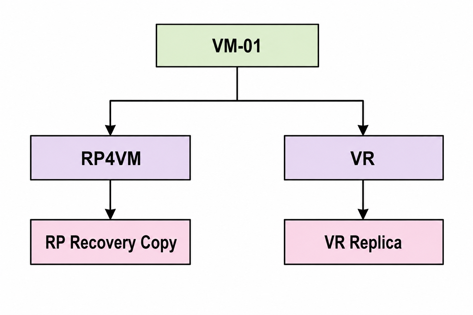

At a high level, the configuration would look like this:
The two products do not form a single replication chain.
RecoverPoint does not normally replicate the vSphere Replication copy, and vSphere Replication does not normally replicate the RecoverPoint copy. Each system independently protects the production VM.

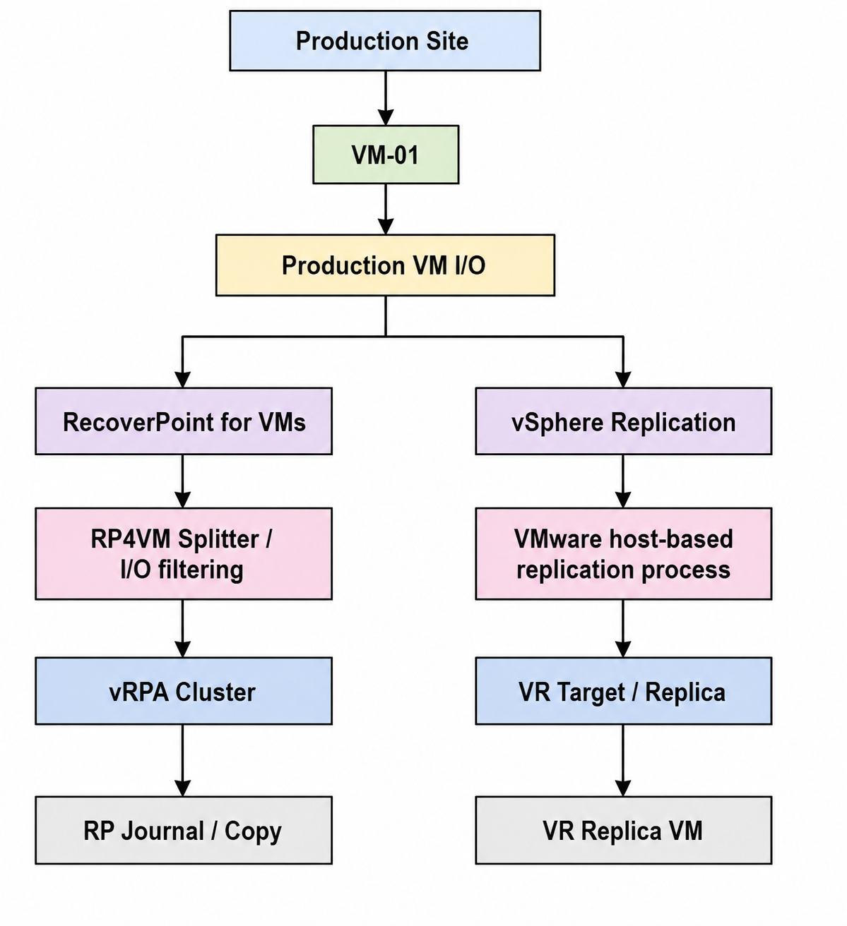

Dell documents that the RP4VM splitter intercepts writes for protected VMs and sends a copy of the write toward the assigned vRPA and designated storage.
Broadcom describes vSphere Replication as host-based replication. After initial synchronization, changes to the protected VM are tracked and transferred as lightweight delta synchronizations according to the configured RPO.
The same production VM becomes the source for two independent protection systems:
This means both systems must:
The resulting replicas are not necessarily identical in terms of recovery point or application state.

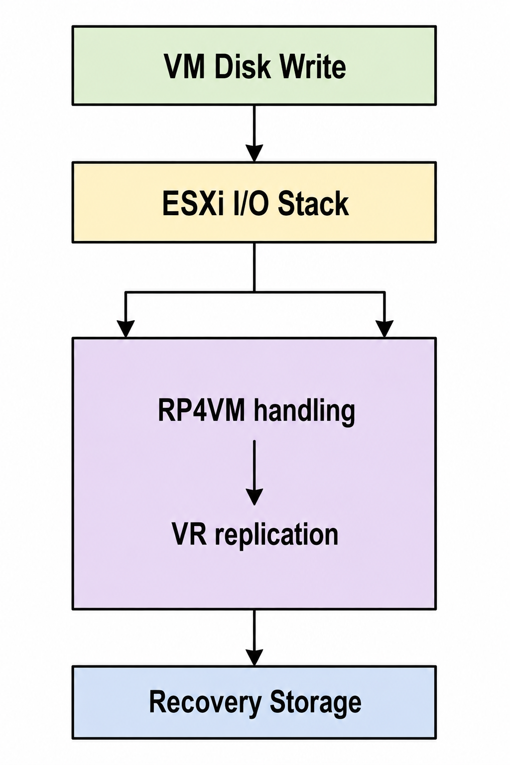

RecoverPoint for VMs uses a hypervisor-level write splitter/filter. Dell's current RP4VM documentation describes the splitter as proprietary software installed on ESXi hosts involved in RP4VM replication; it intercepts writes from protected VMs and sends a copy toward the vRPA (Virtual RecoverPoint Appliance).
For RP4VM 6.x, Dell also documents that the splitter uses VMware VAIO/I/O-filter mechanisms.
vSphere Replication, meanwhile, is a host-based replication technology that tracks VM changes and performs regular delta synchronizations.
Therefore, the simplified conceptual model is:
Multiple replication technologies operating on the same VM introduce additional I/O-processing and interoperability dependencies, and therefore must be explicitly supported and validated rather than assumed to be interchangeable.Therefore, the interoperability of both these products hasn't been tested by VMware by Broadcom, so it's not recommended to use them together.

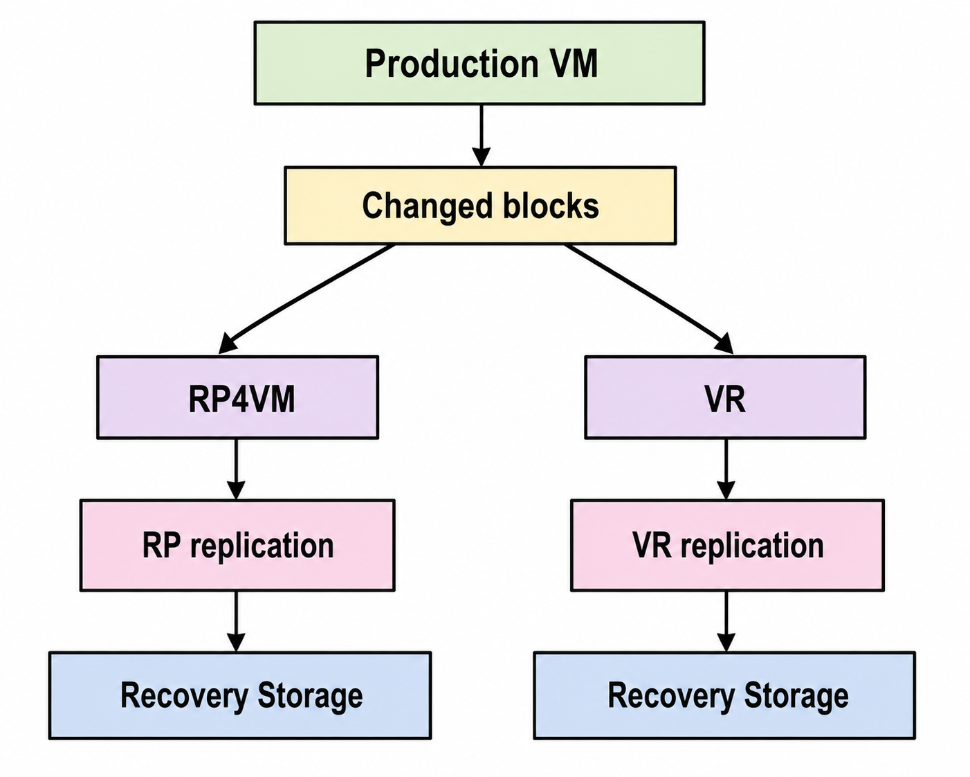

Replicating the same VM twice naturally creates additional workload.
For every change generated by the VM, the infrastructure must support:
This can increase:
Broadcom specifically identifies network performance, storage latency, compute resources, aggressive RPO settings, and replication bandwidth as factors that can affect vSphere Replication performance and RPO compliance.
Consequently, running two replication mechanisms against the same high-change-rate VM can increase the probability of resource contention.
Dual replication may increases the number of components involved in the I/O and data-protection path and can increase resource consumption. In an environment that is already close to its CPU, storage-I/O, or network limits, this additional workload may contribute to latency or replication instability leading to a massive I/O latency or a PSOD.
Because both products have overlapping workflows for obtaining consistent recovery points, and whether guest quiescing occurs depends on the configuration, VMware Tools state, application-consistency requirements, and the specific operation being performed.
If multiple protection or backup tasks attempt to manipulate the VM at the same time, one operation can interfere with another or fail because another protection software is performing the same task or overlapping with the ongoing tasks which may lead to simultaneously freezing the guest operating system and creating locks on VMDK files.

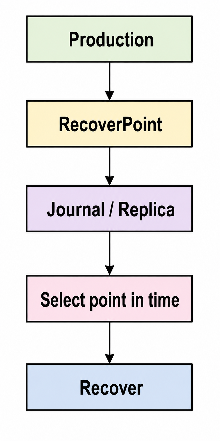

RecoverPoint for VMs is a strong fit when the requirement is:
For example:
14:00 Normal
14:05 Normal
14:10 Ransomware begins
14:11 Files encrypted
14:12 Attack detected
With journal-based recovery, the objective may be to select a recovery point such as:
14:09:30
rather than simply recovering to the latest available replica.
Dell explicitly describes RP4VM as providing recovery to any point in time.
