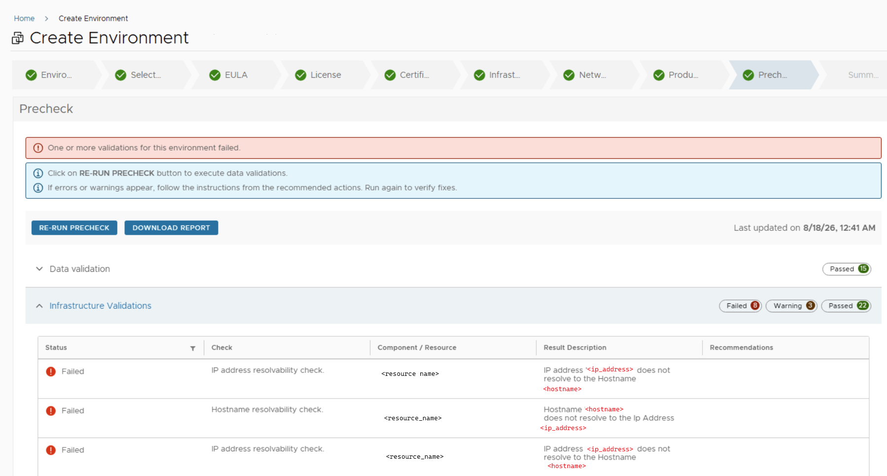

Attempting to deploy Aria products using Aria Suite Lifecycle Ui > Lifecycle Operations > Create Environment > Enter details and Product Info having selected Any product > Run Prechecks : Prechecks fail for "Hostname Resolvability Check" fails with error "Hostname '<hostname>' does not resolve to the Ip Address <ip_address>.'" and "IP Address resolvability check" fails with error "IP address '<ip_address>' does not resolve to the Hostname <hostname>."
The vmware_vrlcm.log showed error message "Executing command : nslookup ; <hostname/ip_address> ; <dns_server_ip>" "DNS output: ;; connection timed out; no servers could be reached"
