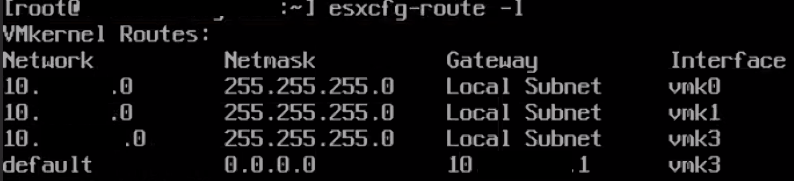

  • Routing table verification shows the default route has shifted to the newly created VMkernel interface.

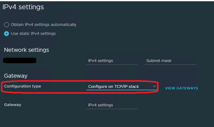

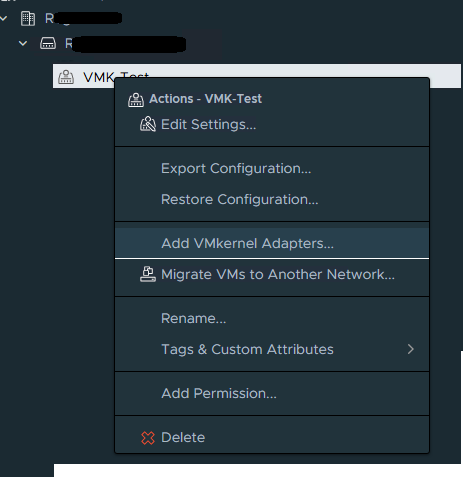

  • VMkernel adapter was created at dvswitch by following the procedure
    DVSSwitch-->Portgroup--> Add VMkernel Adapter
  • The option "Configure on TCP/IP Stack" was selected when assigning an IP to the VMK in the IPV4 Settings
  • The option Configure on TCP/IP stack overwrites the default route with the newly added VMK adapter's  network gateway.
  • If the new adapter's gateway is mapped to route default traffic, and that path cannot reach the vCenter Server address, communication between the host and vCenter drops.

    •  Log in to the ESXi host via SSH or the ESXi Shell.
    • Check the current routing table by running:
          `esxcfg-route -l`
    • Identify the original Management Network gateway IP (associated with vmk0).
    • Reroute the default route to the original Management Network gateway using the following command:
          `esxcli network ip route ipv4 add --gateway ####.####.####.#### --network default
          *(Note: Replace ####.####.####.#### with the actual Management Gateway IP address identified in step 3.)*

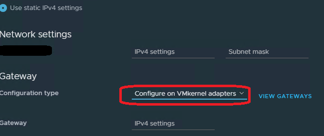

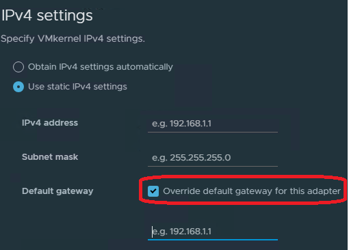

  • To avoid the issue from happening -
    • Either configure VMK individually on every ESXi host and check the option "Override default gateway for this adapter" and mention the gateway of that network.
      Or
    • Select the option "Configure On VMkernel Adapter" instead
