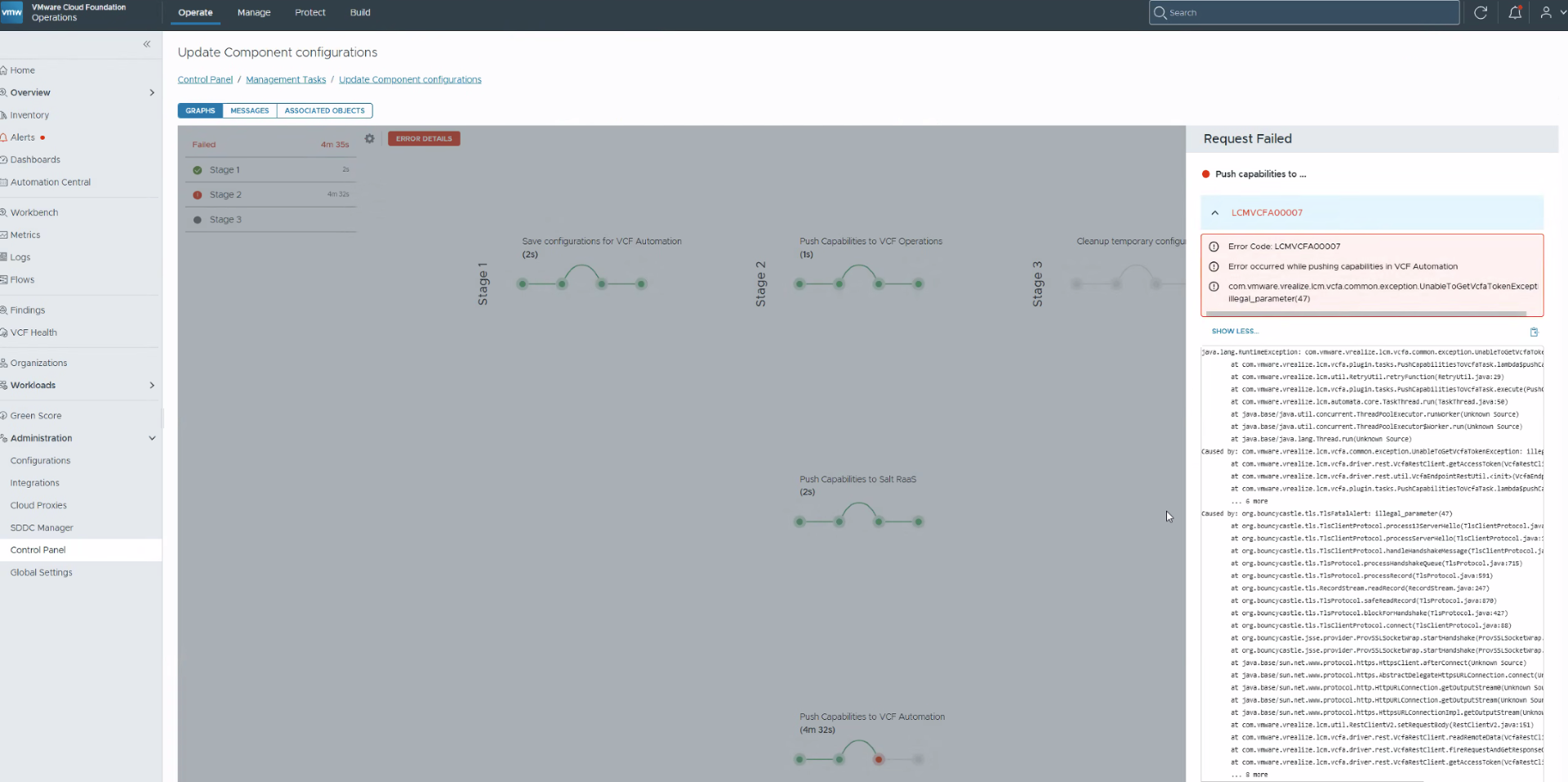

  • Attempting to replace the VCF Automation (VCFA) certificate from the VCF Operations UI fails.
  • The task fails specifically during the "Push capabilities to VCF Automation" at stage 2.
  • The UI and logs display the following error:
    • Error Code: LCMVCFA00007
      Error occurred while pushing capabilities in VCF Automation
      com.vmware.vrealize.lcm.vcfa.common.exception.UnableToGetVcfaTokenException: illegal_parameter(47)
  • Despite the task failure in VCF Operations, the certificate is successfully replaced in the background, and the VCF Automation component shows the new certificate as "Active".
