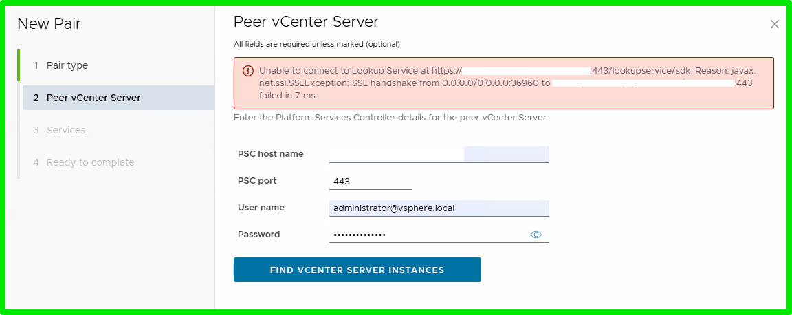

When attempting to pair sites and clicking FIND VCENTER SERVER INSTANCES, the operation fails instantly with the following UI error:
Unable to connect to Lookup Service at https://production.broadcom.com:443/lookupservice/sdk. Reason: javax.net.ssl.SSLException: SSL handshake from 0.0.0.0/0.0.0.0:36960 to recovery.broadcom.com/10.#.#.#:443 failed in 7 ms

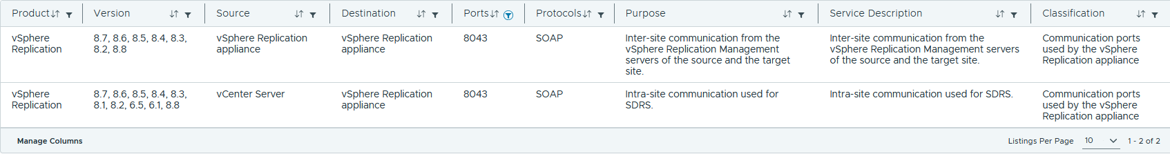

Site Pairing (Connection Reset): The SSL handshake failure is a TCP/IP network rejection, not a certificate thumbprint mismatch. An inline network security device (such as a firewall, AWS security group, load balancer, or IDS/IPS) is allowing the basic TCP connection but actively killing the connection (dropping the SSL Client Hello packet). In this specific scenario, a required outgoing firewall rule for the VRMS appliance over port 8043 was missing on the target/DR site.
Engage your network or cloud security team to verify traffic flow between the source and destination Appliances.
Ensure that an outbound firewall rule is configured to allow traffic over port 8043 for the target Appliance.
Note for Network Teams: Ensure that no SSL Decryption/Deep Packet Inspection (DPI) is intercepting the traffic between the appliances, as VMware requires strict mutual TLS pinning.
VMware Ports and Protocols
