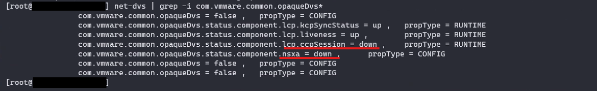

  • After removing NSX-T VIBs from ESXi hosts (often as a workaround for workload migration or VCF issues), one or more Distributed Virtual Switches (VDS) report a status of Down or Invalid State in vCenter Server, even if physical connectivity appears functional.
  • If you run the following command while in root mode on any of the affected hosts, you will see nsx components reporting 'down':
    net-dvs | grep -i com.vmware.common.opaqueDvs*

This issue occurs because residual NSX configurations remain associated with the VDS in the vCenter Server database. vCenter relies on these configuration flags to determine the operational status of the switch; when the VIBs are removed but the database entries remain, vCenter incorrectly flags the VDS as down.
To resolve this state, you must recreate the VDS without importing the stale NSX metadata.
