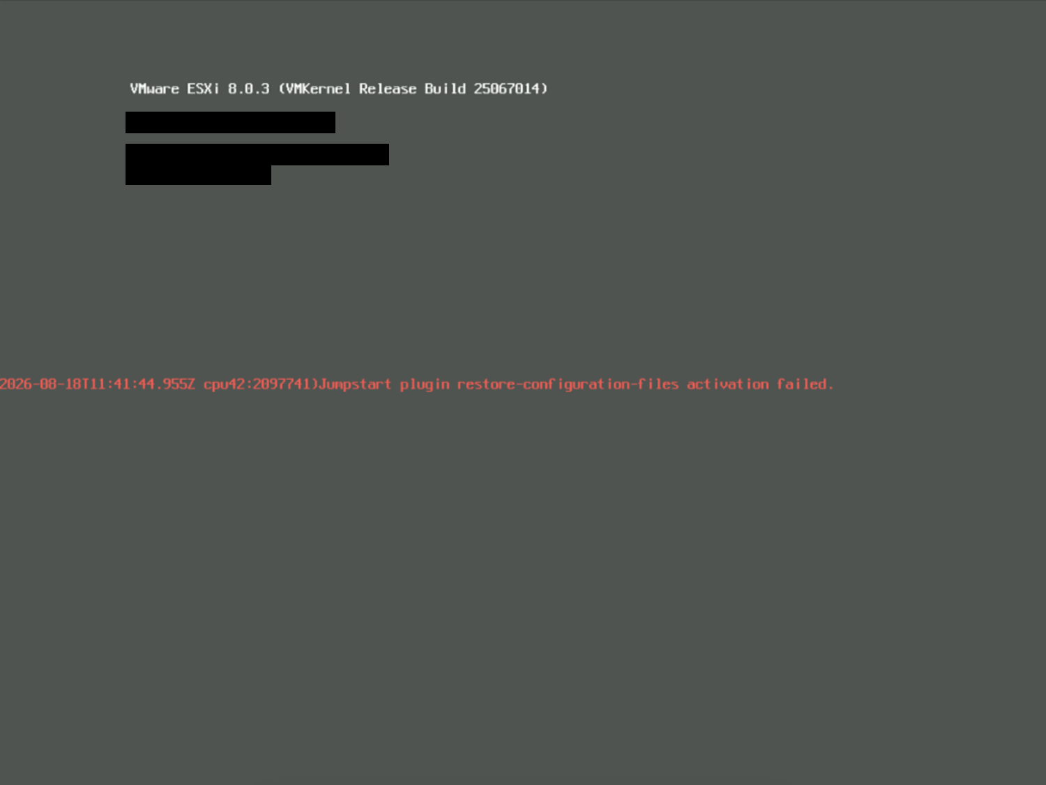

  • When booting an ESXi host, you may observe an error message related to the restore-configuration-files plugin on the direct console screen.
