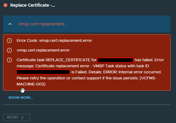

  • In VMware Cloud Foundation (VCF) Operations, the certificate replacement task for the Log Management component with the following error:
    Error Code: vmsp.cert.replacement.error
    Certificate task REPLACE_CERTIFICATE for <FQDN> has failed. Error message: Certificate replacement error - VMSP Task status with task ID <ID> is Failed. Details: ERROR: Internal error occurred. Please retry the operation or contact support if the issue persists. [VCFMS-MACHINE-003]
