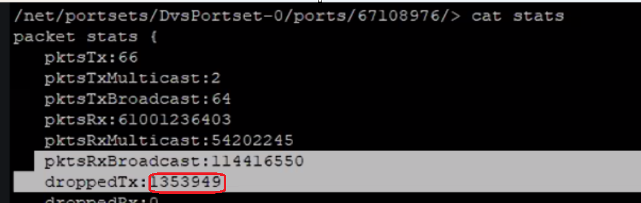

A Virtual Machine (VM) connected to a port group on a vSphere Distributed Switch (VDS) and specific VLAN experiences complete network connectivity loss and is unable to ping its default gateway. Other VMs located on the same port group and residing on the same ESXi host can successfully ping the default gateway.
Packet captures reveal ARP packets successfully reaching the Distributed Virtual Port (DV port) ID, but they fail to traverse or reach the ESXi host physical uplink. Inspection of the DV port statistics shows the droppedTx packet counter continuously incrementing.
