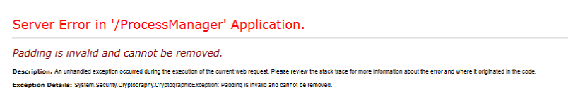

After a clean install of Symantec Workflow 8.7.3 (with a new database created during setup), attempting to redirect the new 8.7.3 server to an existing production Workflow 8.5 RU4 ProcessManager database using standard connection string redirection steps (e.g., "Moving Workflow SQL database to a new server" (KB 172481)) causes the ProcessManager console to fail to launch on the new server.
customErrors mode is set to Off in web.config ( default location ; C:\Program Files\Symantec\Workflow\ProcessManager\web.config ) , errors such as Padding is invalid and cannot be removed occur during decryption (e.g., decrypting SMTP server passwords or database credentials in Master Agent Settings).System.Net.WebException: Unable to connect to the remote server ---> System.Net.Sockets.SocketException: No connection could be made because the target machine actively refused it [::1]:443

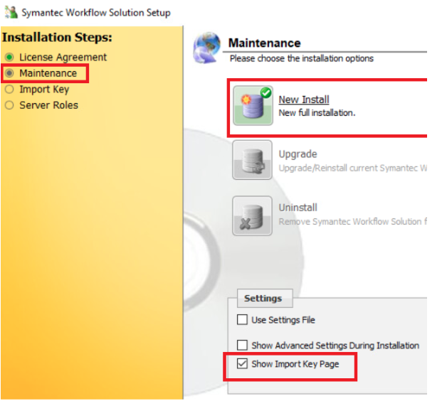

Missing KMS Encryption Key: Each Workflow server installation generates its own KMS encryption key used to encrypt/decrypt sensitive database values (SMTP passwords, database credentials, system accounts). If a new Workflow instance points to an existing database without importing the original server's KMS key during setup, it cannot decrypt existing database records.
Post-Installation Redirection Limitation: Connecting an existing installation to an "alien" database by manually updating connection strings in configuration files (web.config, setup.xml, etc.) does not transfer or migrate the required KMS encryption keys. Importing KMS keys and running schema updates is only supported during the initial installation wizard ("Show Import Key Page").
Database Schema & Version Mismatch: Running two different versions of Workflow (e.g., 8.5 RU4 and 8.7.3) against the same database causes failures due to schema expectations and object caching inconsistencies.
To connect a new 8.7.3 Workflow server to an existing production 8.5 RU4 ProcessManager database, the KMS key must be exported from the source server and imported during a clean reinstallation on the target server.

Step 3: Reinstall Workflow and Import the KMS Key
At the Maintenance step, check the box for Show Import Key Page.
When prompted, import the .kms key file exported in Step 1.
On the Database Configuration page, point to the existing ProcessManager SQL database.
Complete the installation.
