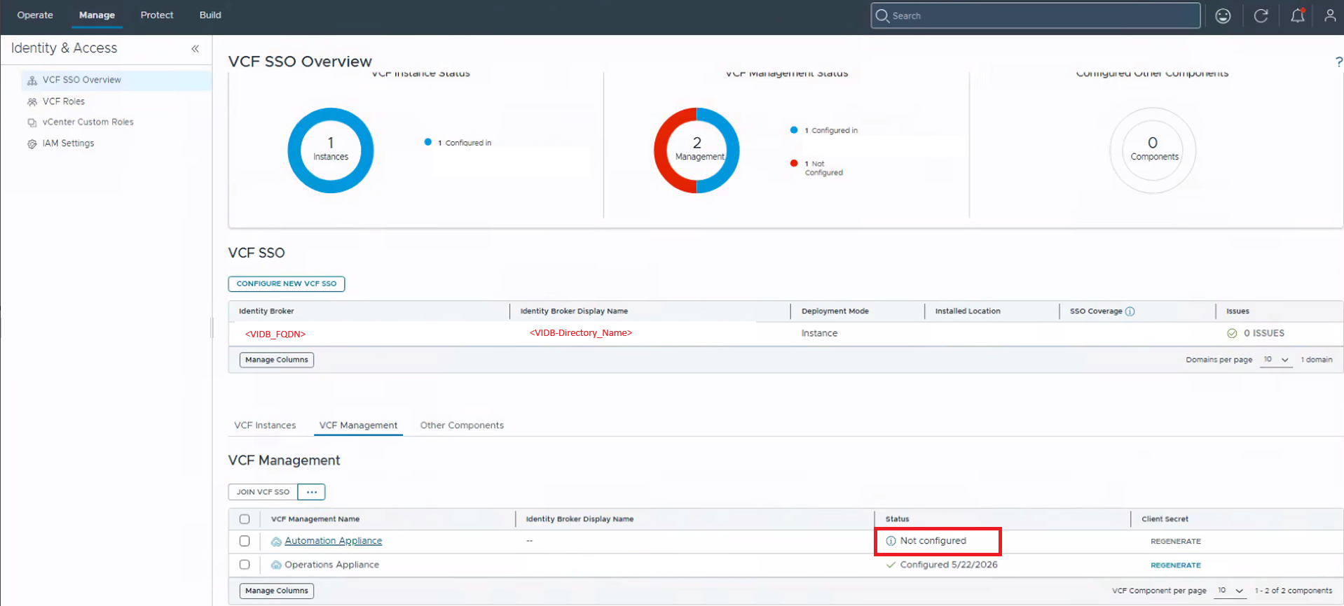

  • In VCF Operations > Manage > Fleet Management > Identity and Access > VCF SSO Overview, the Aria Automation Appliance SSO configuration is displayed as "Not Configured"

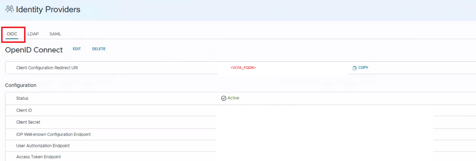

  • In the VCF Automation interface > Administration > Identity Providers, the VCF SSO configuration is missing, and only the OIDC configuration is visible.
