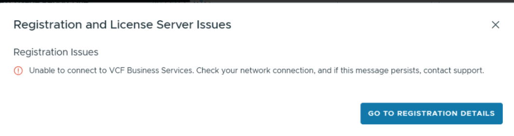

-You may also observe below Error in VCF Operations UI Console :
VMware Cloud Foundation 9.1
