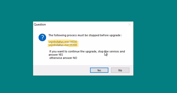

The following process must be stopped before upgrade :
uxjob######:PROCESS_ID
When launching the setup on Windows, a popup error message will appear as below so it's simple to detect which process must be killed
