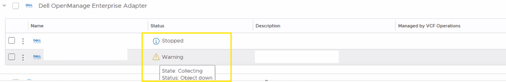

  • The collection status for Dell OpenManage Enterprise (OME) adapter in VCF Operations shows "Stopped" or "Warning".
