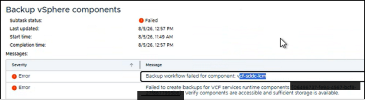

Manual Backup fails across VMware Cloud Foundation Components:
"Failed to create backups for VCF services runtime components 'XXXXXXXXXXXXXXXXXXXXXXXXXXXXXXXXX'. Verify components are accessible and sufficient storage is available. Backup workflow failed for component: vcf-sddc-lcm".
