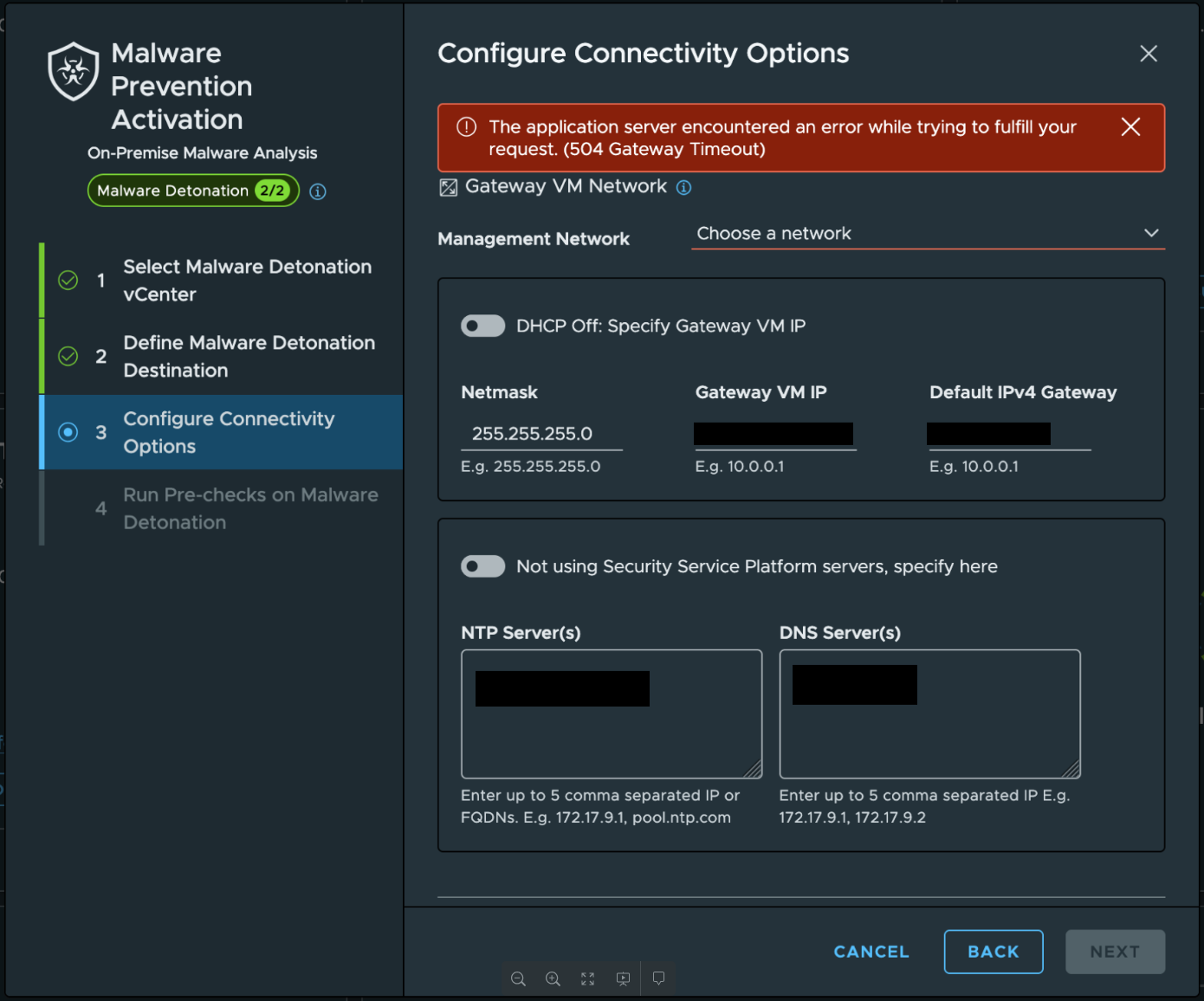

vDefend MPS phase 2 configuration will fail if the vCenter is configured with a SSO domain set to anything other than vsphere.local. The UI will display the following 504 error
Security Services Platform (SSP) 5.2.0 with Static Analysis (Phase 1) of MPS installed
Dynamic Analysis requires creation of a vCenter Service account and this account is created using the built-in SSO domain "vsphere.local". If any other identity provider is used than "vsphere.local" then the activation fails in the UI with a "504 timeout" error.
The Dynamic Analysis activation phase uses the newly created service account to connect to the vCenter, but fails with a login error as seen in the malware-analysis-masapi pod logs:

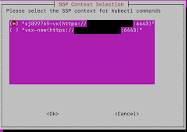

When you run the script it will open a prompt screen to select the SSP to edit. If you have multiple SSP instances, ensure you select the specific SSP instance that manages the vCenter where you are attempting to activate Malware Detonation.
Select the SSP instance when prompted :
