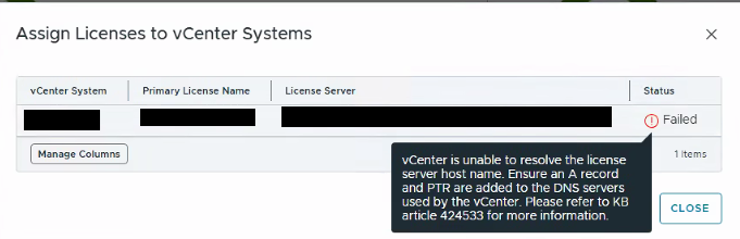

  • In VCF Operations (VCF OPS) 9.1, when the License Server is registered in Disconnected Mode, attempting to assign a license to vCenter in the VCF Operations UI shows the following error: 'License could not be assigned to vCenters.'
  • Clicking Details shows the following message: 'vCenter is unable to resolve the license server host name. Ensure an A record and PTR are added to the DNS servers used by the vCenter.'
